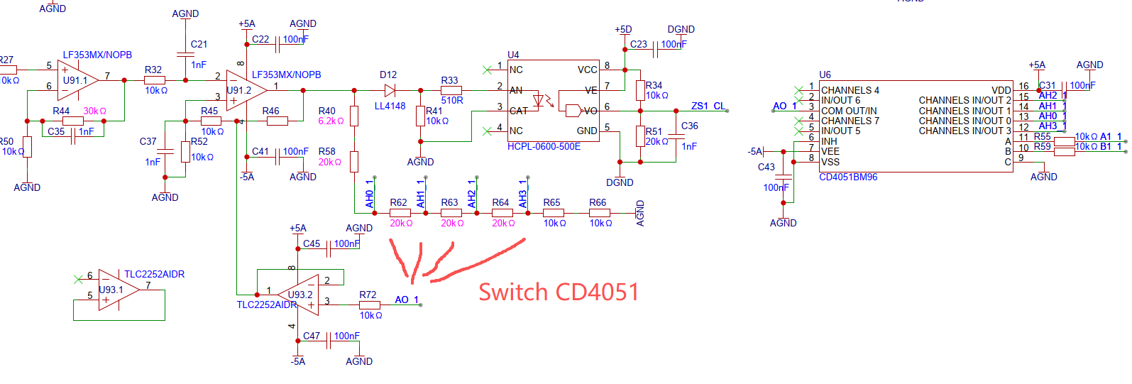

The LF353 is powered from +5 V / -5 V and is used as an open-loop comparator with hysteresis. The output also drives an optocoupler input through a diode and series resistor.

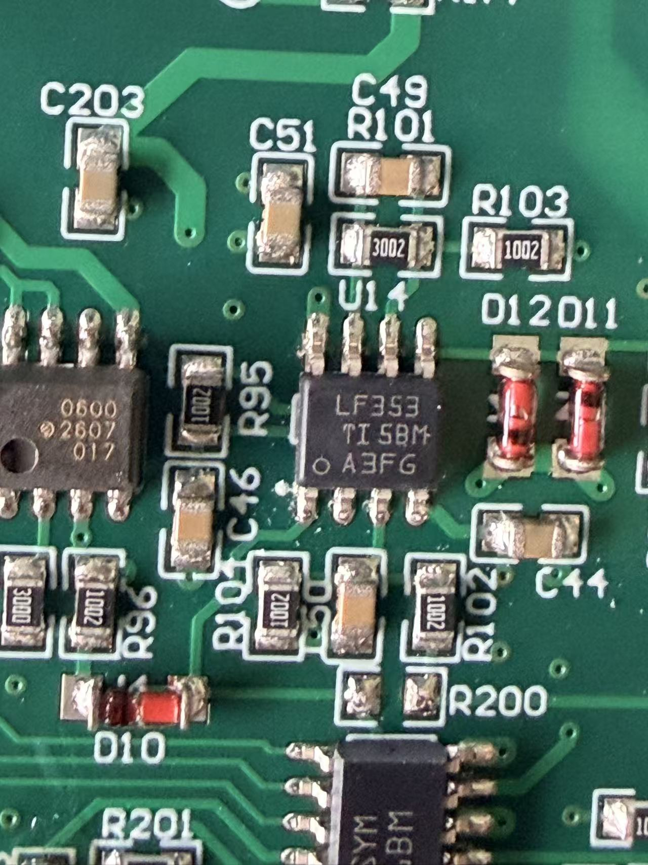

Board 1 CS-V1.0 LF353 TI 46M A434 3.37 V
Board 2 CS-V1.1 LF353 TI 46M A434 3.35 V
Board 3 CS-V1.1 LF353 TI 53K CL42 4.49 V
Board 4 ZS/JX-V1.1 LF353 TI 53K CL42 4.747 V

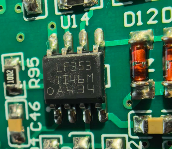

Board 4, after replacing LF353 ZS/JX-V1.1 LF353 TI 46M A434 3.59 V
The most important observation is from Board 4. We replaced only the LF353 device on the same PCB, without changing the surrounding circuit. The output voltage changed from approximately 4.747 V with the "53K CL42" device to 3.59 V with the "46M A434" device.
Therefore, the difference appears to follow the LF353 device rather than the PCB.
Both devices are marked as TI LF353. Since the LF353 is not a rail-to-rail output amplifier, the approximately 3.3–3.6 V output level at a +5 V supply appears reasonable to us. However, the approximately 4.5–4.75 V output level of the "53K CL42" devices is much closer to the positive supply rail.

We can provide the schematic, photographs of the device markings, supply voltages, output load current, and additional measurements if required.
