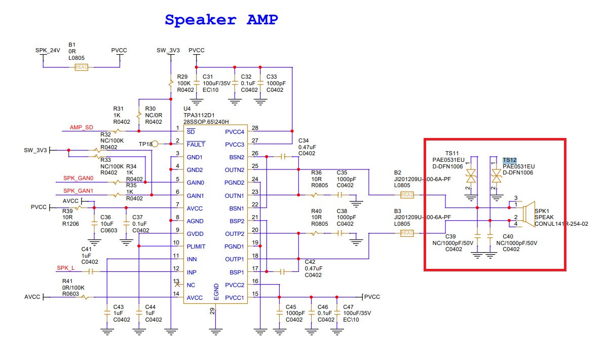

Our new product uses the TPA3112D1 IC, and the circuit design is shown in the diagram below.
After trial production of 10 boards, we found short circuits in components at positions
TS11 and TS12 on every board.
What could be causing this?
Please also help us confirm whether the circuit design is appropriate. Thank you.
