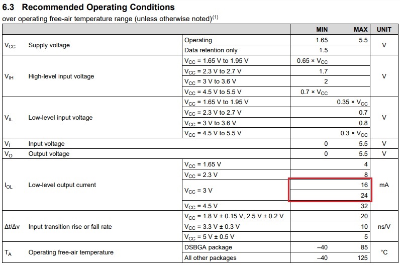

Hi Team,
Could you please tell me what is the difference between the red rectangle below two spec 16mA and 24mA? Thanks.
