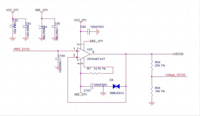

OPA548 输出关不掉
Other Parts Discussed in Thread: OPA548
OPA548供电为±27v,输入5v,放大倍数1,E/S拉到-27V时发现有-8.8V输出;E/S悬空输出为5v;为什么E/S拉到-27V时,还是有输出呢,应该是output disable .求解
