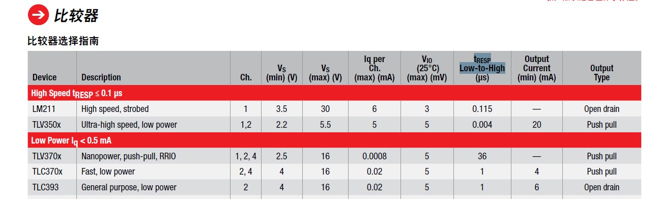

tRESP Low-to-High这个参数是什么?
Other Parts Discussed in Thread: LM211

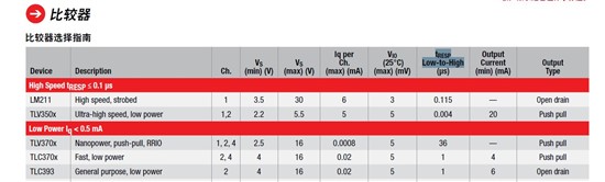

如图所示,那个参数什么意思啊?是不是低电平升高到高电平所需的时间?设计时候要不小于该时间??
  • 请参考LM211 datasheet中的解释:
    The response time specified is for a 100-mV input step with 5-mV overdrive and is the interval between the input step function and the
    instant when the output crosses 1.4 V.
