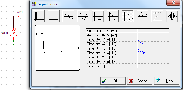

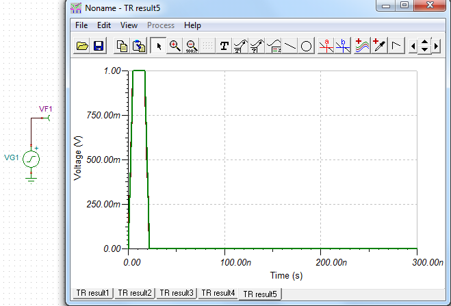

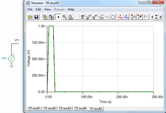

大家好,请问如何在TI-NA里的信号编辑器中生成自己的激励波形,比如:产生上升沿5ns、下降沿5ns、脉冲宽度12ns的单脉冲激励信号!

    The General waveform permits waveform definition over 6 intervals and two levels, with a time shift parameter as well.

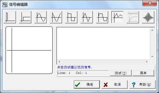

    When you select the Piecewise linear waveform you must specify the time-voltage/current pairs which describes the corner of the waveform. The values must be entered according to the PSpice syntax. Time and value scale factors can be used.

    Note: You can also define excitations by tables (list of values) using the Spice PWL function.
    For more information check the PWL.TSC circuit in the TINA's EXAMPLES folder.
