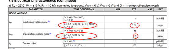

INA849: the noise related parameter items at datasheet is different with the Tina simulation
Part Number: INA849

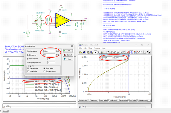

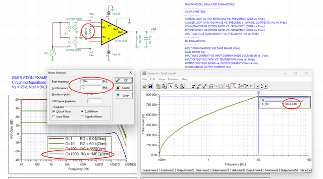

i found the parameters given by datasheet is not  consistent with my tina simulation results, the simulation is much better than parameters  at datasheet.  the simulation can not be design reference,right?
i am going to use INA849  pre-amplifying  EEG && FECG signals and limit the RTI lower than 1uVpp, the system bandwidth is 0.1-200hz,and the gain set 50, could it  achive the desgin goal?
