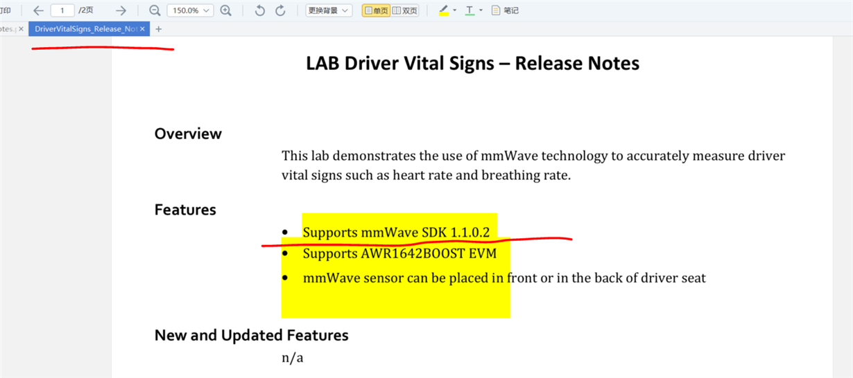

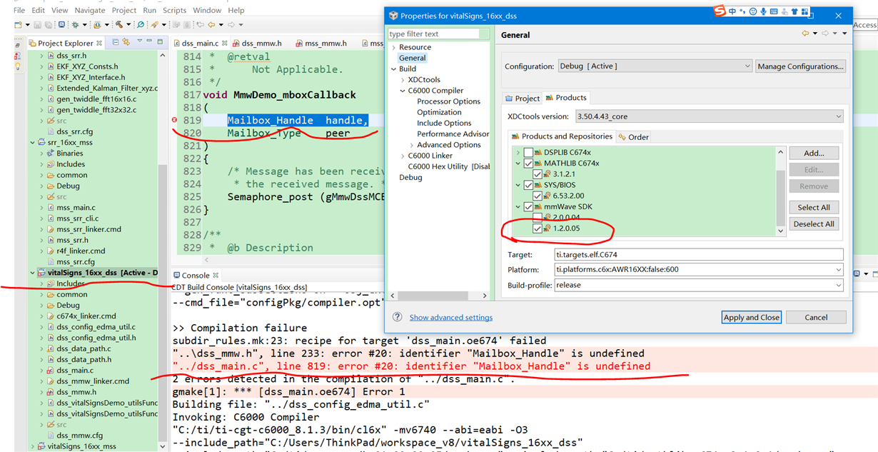

您好,我使用了ti resource explorer中的mmw_sdk_demo -16xx,导入ccs后,编译dss报如下错误,请问是什么原因?我demo和sdk应该都是最新的,sdk换成1.1旧版本后同样出错,请问下该如何解决?谢谢
"..\dss_mmw.h", line 256: error #20: identifier "Mailbox_Handle" is undefined
"../dss_data_path.c", line 908: error #20: identifier "EDMA_INSTANCE_A" is undefined
"../dss_data_path.c", line 955: error #20: identifier "EDMA_INSTANCE_A" is undefined
"../dss_data_path.c", line 1001: error #20: identifier "EDMA_INSTANCE_A" is undefined
"../dss_data_path.c", line 1047: error #20: identifier "EDMA_INSTANCE_A" is undefined
"../dss_data_path.c", line 1084: error #20: identifier "EDMA_INSTANCE_A" is undefined
"../dss_data_path.c", line 1122: error #20: identifier "EDMA_INSTANCE_A" is undefined
"../dss_data_path.c", line 1238: error #20: identifier "EDMA_INSTANCE_A" is undefined
"../dss_data_path.c", line 2057: error #20: identifier "EDMA_INSTANCE_A" is undefined
"../dss_data_path.c", line 2268: error #20: identifier "EDMA_INSTANCE_A" is undefined
"../dss_data_path.c", line 2737: error #20: identifier "EDMA_INSTANCE_A" is undefined
"../dss_data_path.c", line 2894: error #148: declaration is incompatible with "void MmwDemo_dataPathObjInit(MmwDemo_DSS_DataPathObj *, MmwDemo_DSS_dataPathContext_t *, MmwDemo_CliCfg_t *, MmwDemo_CliCommonCfg_t *, MmwDemo_Cfg *)" (declared at line 513 of "C:/ti/mmwave_sdk_01_02_00_05/packages/ti/demo/xwr16xx/mmw/dss/dss_data_path.h")
