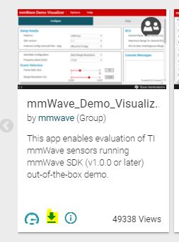

使用mmWave Demo Visualizer记录保存的AWR1443BOOST的数据流,该如何解析?有教程么?
  • Hi Bo Luo,
    To process the recorded data: See the Visualizer User's Guide, section 4.4, to understand what the data contains. Information on the actual data is available in the doxygen - <mmWave_SDK_Install_DIR>\packages\ti\demo\xwr16xx\mmw\docs\doxygen\html\index.html.
    User's Guide: www.ti.com/.../swru529a.pdf
    There is a demo in beta that saves the recorded data to a human readable CSV file - you can read the code and understand the data conversion process:
    mmWave visualizer with the LOG function: dev.ti.com/.../
    Thanks
  • The data saved in this file is the exact same data and format that is transmitted out of the mmWave device over the DATA_port. Users should see the mmWave demo doxygen in the mmWave SDK package to understand the format of the data and how to parse it.

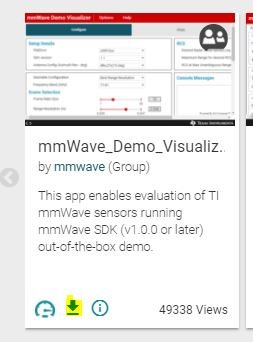

  • 感谢回复!使用您提供的mmWave visualizer输出了 CSV file,我想再请问这个mmWave visualizer的版本有没有离线的呢?
  • 你好,
    带LOG功能这个beta版本暂时没有。你可以使用release版本的离线版本
