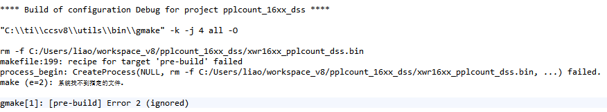

CCS编译DEMO出错,每个都要出错
**** Build of configuration Debug for project pplcount_16xx_dss ****
"E:\\Program Files\\ccs8\\ccsv8\\utils\\bin\\gmake" -k -j 8 all -O
rm -f C:/Users/DeapOcean/workspace_v8/pplcount_16xx_dss/xwr16xx_pplcount_dss.bin
makefile:199: recipe for target 'pre-build' failed
process_begin: CreateProcess(NULL, rm -f C:/Users/DeapOcean/workspace_v8/pplcount_16xx_dss/xwr16xx_pplcount_dss.bin, ...) failed.
make (e=2): 系统找不到指定的文件。
gmake[1]: [pre-build] Error 2 (ignored)
