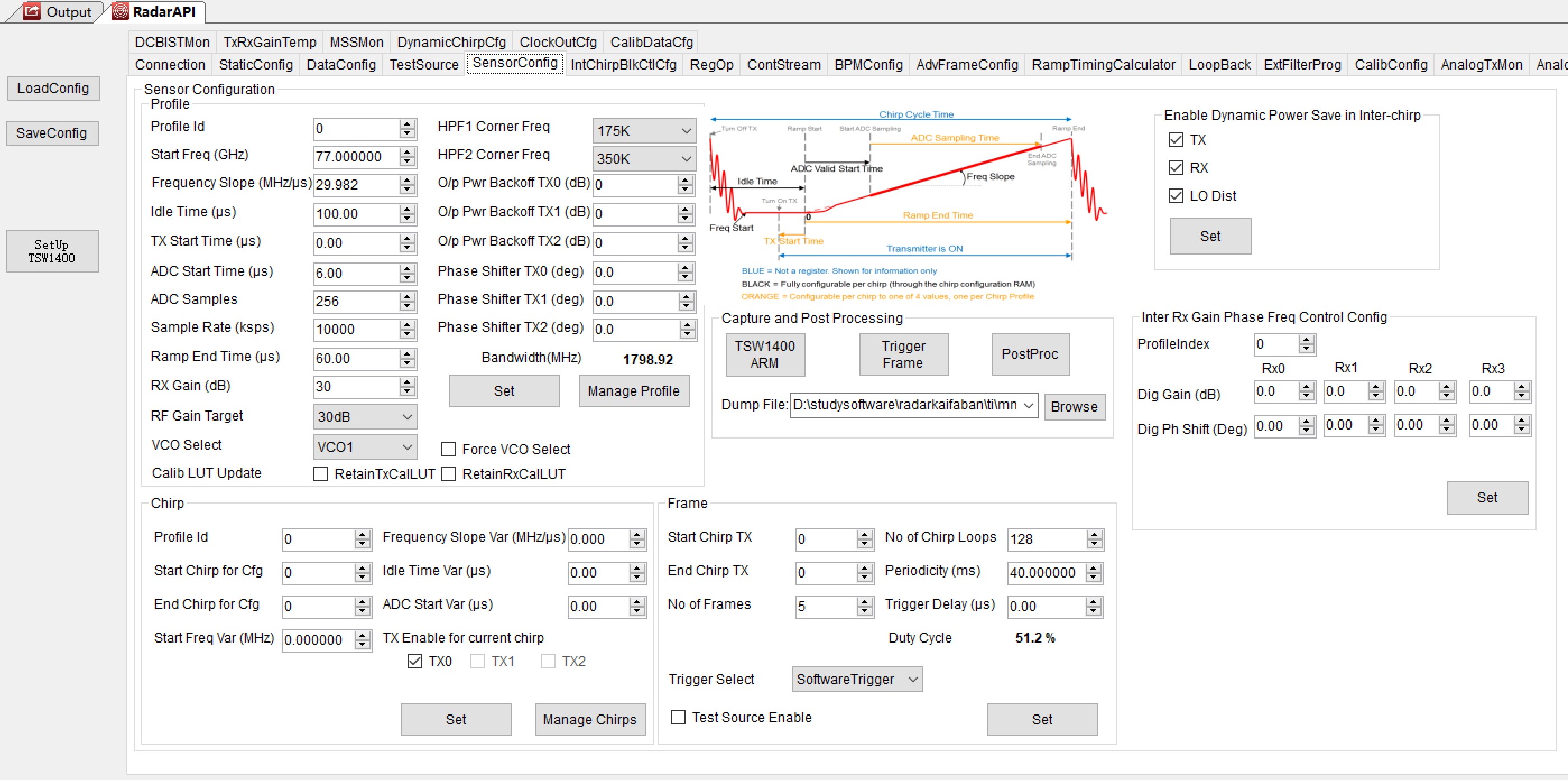

按照mmwave studio的user guide操作,所有配置和chirp均按照user guide所写。
一些都顺利,直到SensorConfig栏下的TSW1400ARM按钮时,HSDC Pro 没有任何反应,output界面报错,
错误提示Frame Config has not been populated,但我已经注意了frame不为零之类的问题,而且在另一台电脑同样的软件,同样的设置可以顺利运行,
SensorConfig界面如下:
想问下,是哪里出了问题,请帮忙查找原因。
output窗口显示错误如下:
[19:59:37]  [RadarAPI]: Error:
[19:59:37]
[19:59:37]  ... MWMCR::EvaluateFunction error ...
[19:59:37]  04-Dec-2018 19:59:37: Frame Config has not been populated,1,
[19:59:37]  Error in => setup_for_triggered_capture_max_30_frames.m at line 6.
[19:59:37]
[19:59:37]  ... Matlab M-code Stack Trace ...
[19:59:37]      at
[19:59:37]  file C:\Users\sungu\AppData\Local\Temp\sungu\mcrCache8.5.1\Matlab1\Logging\log_status.m, name log_status, line 32.
[19:59:37]      at
[19:59:37]  file C:\Users\sungu\AppData\Local\Temp\sungu\mcrCache8.5.1\Matlab1\MatlabPostPr\setup_for_triggered_capture_max_30_frames.m, name setup_for_triggered_capture_max_30_frames, line 6.
[19:59:37]
[19:59:37]
[19:59:37]  Trace:
[19:59:37]     在 MathWorks.MATLAB.NET.Utility.MWMCR.EvaluateFunction(String functionName, Int32 numArgsOut, Int32 numArgsIn, MWArray[] argsIn)
[19:59:37]     在 MathWorks.MATLAB.NET.Utility.MWMCR.EvaluateFunction(String functionName, MWArray[] argsIn)
[19:59:37]     在 MatlabPostProcGui.MatlabPostProcGUIClass.setup_for_triggered_capture_max_30_frames(MWArray FilePathWithName)
[19:59:37]     在 AR1xController.frmAR1Main.iStartTSW1400IF()
