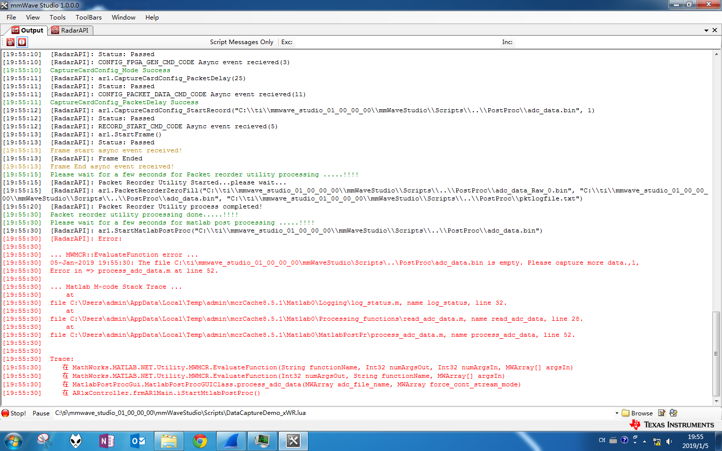

您好! 我按照DCA1000_Quick_Start_Guide 跑示例,SPI及网卡连接均正常,但是在trigger frame后 很快返回 Frame end, 最后也没有获得数据(wiresharp监测不到返回的数据包), 运行结果下:
使用的软硬件版本
1243EVM ES2.0
MMWAVE STUDIO Release 01.00.00
希望能够获得解答。
感谢

  • 您好! 按照视频的步骤,最后一步 trigger frame 后,没有数据,post processing 按钮也无法点击
  • 你好,
    能否贴出全部的output信息,帮助定位问题。谢谢
  • 全部信息如下:  麻烦了!

    [19:55:13] [RadarAPI]: ar1.StartFrame()
    [19:55:13] [RadarAPI]: Status: Passed
    [19:55:13] Frame start async event received!
    [19:55:13] [RadarAPI]: Frame Ended
    [19:55:13] Frame End async event received!
    [19:55:15] Please wait for a few seconds for Packet reorder utility processing .....!!!!
    [19:55:15] [RadarAPI]: Packet Reorder Utility Started...please wait...
    [19:55:15] [RadarAPI]: ar1.PacketReorderZeroFill("C:\\ti\\mmwave_studio_01_00_00_00\\mmWaveStudio\\Scripts\\..\\PostProc\\adc_data_Raw_0.bin", "C:\\ti\\mmwave_studio_01_00_00_00\\mmWaveStudio\\Scripts\\..\\PostProc\\adc_data.bin", "C:\\ti\\mmwave_studio_01_00_00_00\\mmWaveStudio\\Scripts\\..\\PostProc\\pktlogfile.txt")
    [19:55:20] [RadarAPI]: Packet Reorder Utility process completed!
    [19:55:30] Packet reorder utility processing done.....!!!!
    [19:55:30] Please wait for a few seconds for matlab post processing .....!!!!
    [19:55:30] [RadarAPI]: ar1.StartMatlabPostProc("C:\\ti\\mmwave_studio_01_00_00_00\\mmWaveStudio\\Scripts\\..\\PostProc\\adc_data.bin")
    [19:55:30] [RadarAPI]: Error:
    [19:55:30]
    [19:55:30] ... MWMCR::EvaluateFunction error ...
    [19:55:30] 05-Jan-2019 19:55:30: The file C:\ti\mmwave_studio_01_00_00_00\mmWaveStudio\Scripts\..\PostProc\adc_data.bin is empty. Please capture more data.,1,
    [19:55:30] Error in => process_adc_data.m at line 52.

  • 你好,
    看了你的log,采集应该成功了,能否检查一下BIN文件的尺寸?以下两个文件。
    如果BIN文件是有内容的,那么检查一下你的matlab runtime是否成功安装?
    Install Matlab Runtime Engine (Version 8.5.1): It is used to run the Post-Processing utility within mmWaveStudio. in.mathworks.com/.../MCR_R2015aSP1_win32_installer.exe
    参考文档:"C:\ti\mmwave_studio_01_00_00_00\docs\mmwave_studio_user_guide.pdf"
  • 你好!
    我也遇到了相同的问题,之前的操作都是passed,一切正常,最后在点击Trigger Frame后output也显示Frame End async event received!,但接收的bin文件都为0kb,后续也无法点击PostProc,与帖主遇到的问题一样,不知道最后帖主是怎么解决的呢,您又有什么样的建议呢~
  • 您好,我的问题也类似,adc_data_Raw_0.bin能够采集到数据,但是adc_data.bin的大小为0 kb,点击PostProc后即会出现和题主同样的问题。
  • 采集板寄存器配置的问题 选为软件触发
  • 谢谢,采集卡设置的是软件触发;我是win7系统,换台win10的电脑就可以。但是还是不知道这个错误的根本原因。
  • 你好,我想问一下,在哪个位置设置采集卡的触发?我在sensor configuration选项卡里只找到了frame的触发方式选择
