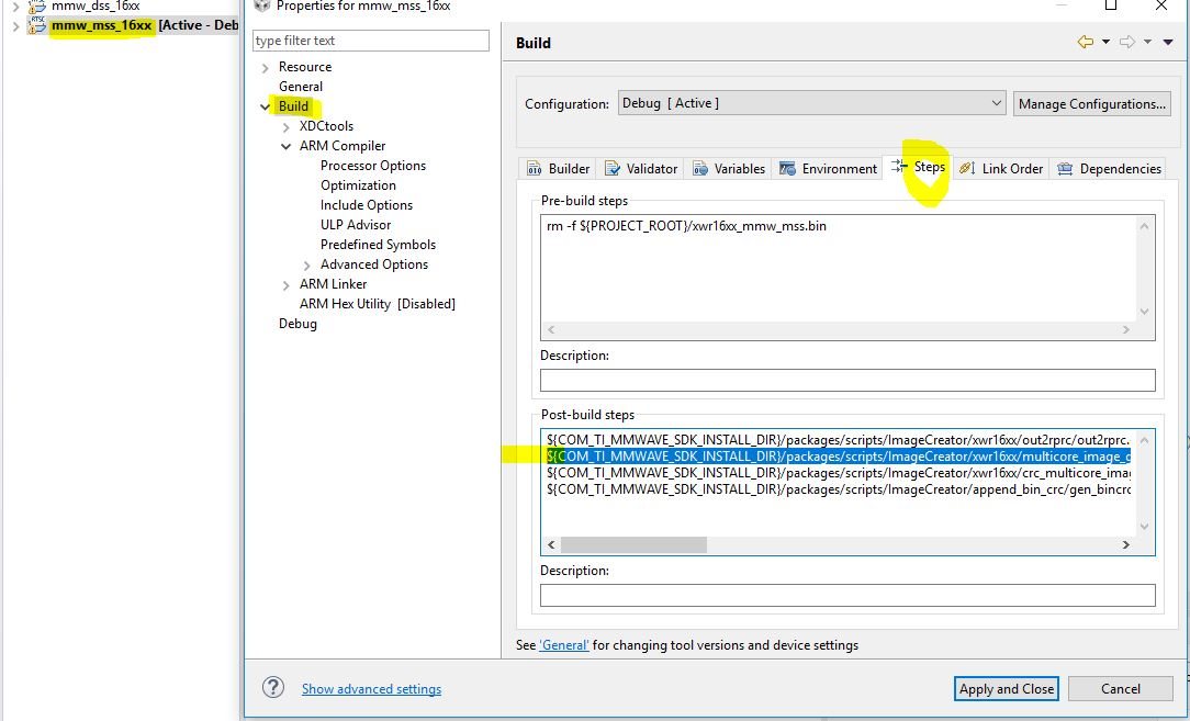

编译mss的时候会将dss.bin编译到一起形成一个lab.bin,请问这个dss.bin的路径在哪里修改
你好,
MSS project->right click->Properties->Build->Steps->Post-Build-steps
修改以下部分就好
${COM_TI_MMWAVE_SDK_INSTALL_DIR}/packages/scripts/ImageCreator/xwr16xx/multicore_image_generator/MulticoreImageGen.exe LE 37 0x00000006 xwr16xx_mmw.bin 0x35510000 xwr16xx_mmw_mss.bin 0xb5510000 ${COM_TI_MMWAVE_SDK_INSTALL_DIR}/firmware/radarss/xwr16xx_radarss_rprc.bin 0xd5510000 ${WORKSPACE_LOC}/mmw_dss_16xx/Debug/xwr16xx_mmw_dss.bin
