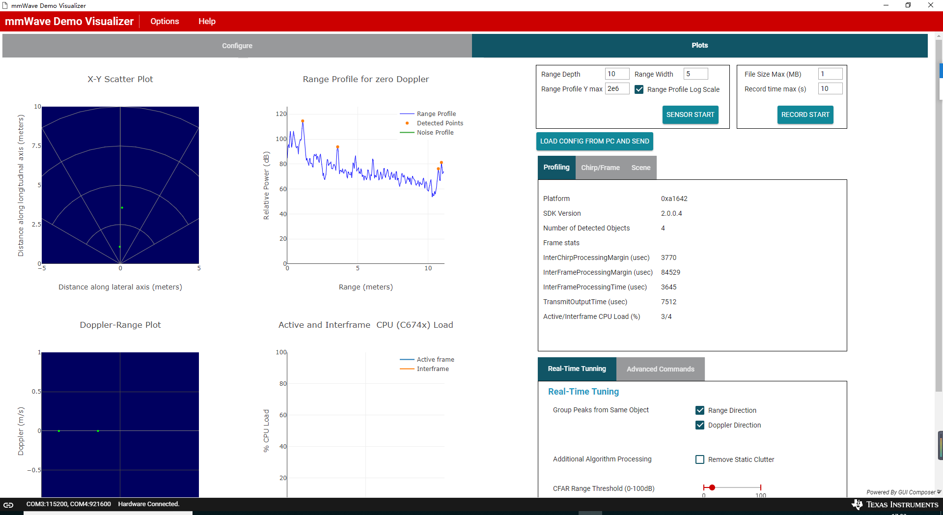

4.使用默认配置参数打开mmwave演示可视化器,单击Send config to mmwave device
