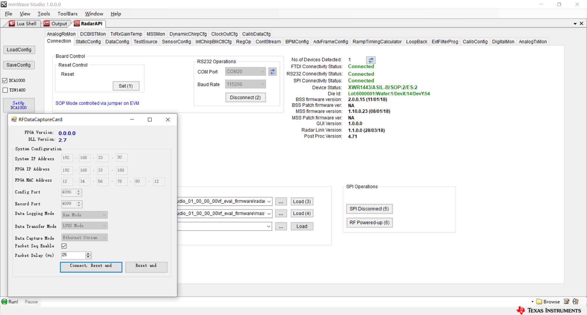

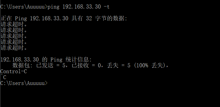

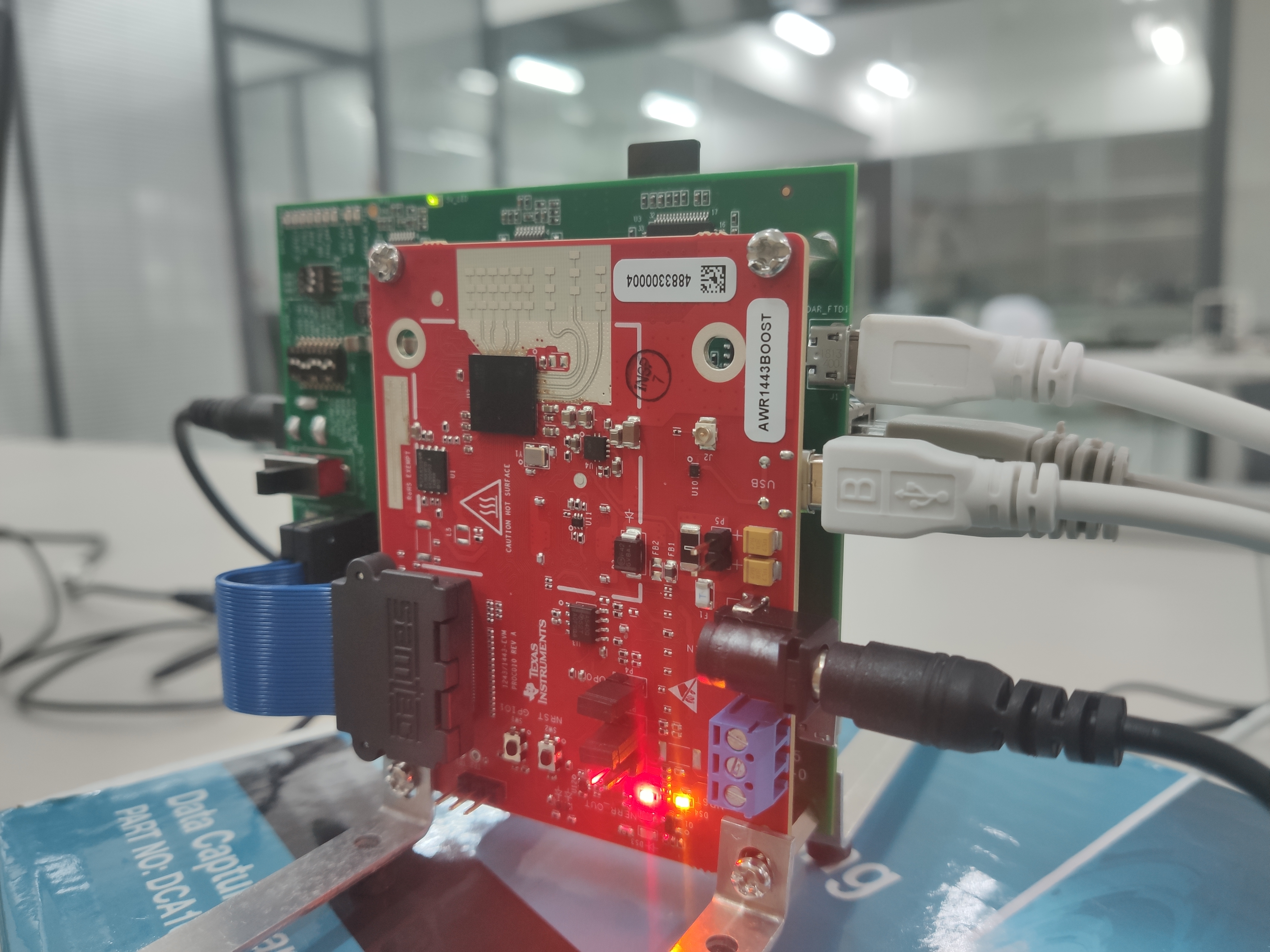

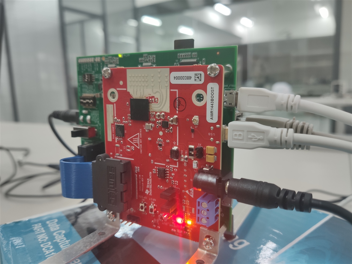

       最近在使用AWR1443 E2.0+DCA1000EVM采集实时数据,按照DCA1000_Quick_Start_Guide和user guide操作,所有步骤都完成了,但是网口一直显示连接失败,我确定已经把本地连接静态IP地址设置为192.168.33.30,并且在mmwave studio中其他所有操作都能正常进行(之前的所有步骤也全部都完成,该安装的包也都安装了),我把防火墙和杀毒软件全部关闭了,网线也换了三根,也还是没有用,我ping了一下设置的IP地址,显示的是连接超时,请问还有什么解决办法?(我看到社区里其他人也有这样的问题,但是并没有一个有效的解决方案)
以下为mmwave studio / output打印信息:
[14:48:46]  [RadarAPI]: Opening Gpio Control Port()
[14:48:46]  [RadarAPI]: Status: Passed
[14:48:47]  [RadarAPI]: Opening Board Control Port()
[14:48:47]  [RadarAPI]: Status: Passed
[14:48:48]  [RadarAPI]: ar1.FullReset()
[14:48:48]  [RadarAPI]: Status: Passed
[14:48:49]  [RadarAPI]: Closing Board Control Port()
[14:48:49]  [RadarAPI]: Status: Passed
[14:48:49]  [RadarAPI]: Closing Gpio Control Port()
[14:48:49]  [RadarAPI]: ar1.SOPControl(2)
[14:48:58]  [RadarAPI]: ar1.Connect(20,115200,1000)
[14:48:59]  [RadarAPI]: ar1.Calling_IsConnected()
[14:49:01]  [RadarAPI]: ar1.SelectChipVersion("XWR1443")
[14:49:01]  [RadarAPI]: Status: Passed
[14:49:02]  [RadarAPI]: ar1.SelectChipVersion("XWR1443")
[14:49:02]  [RadarAPI]: Status: Passed
[14:49:02]  [RadarAPI]: ar1.SaveSettings('C:\Users\Auuuuu\AppData\Roaming\RSTD\ar1gui.ini')
[14:49:03]  [RadarAPI]: ar1.DownloadBSSFw("D:\\ti_mmwave\\mmwave_studio\\mmwave_studio_01_00_00_00\\rf_eval_firmware\\radarss\\xwr12xx_xwr14xx_radarss_ES2.0.bin")
[14:49:03]  [RadarAPI]: Downloading BSS ROM Legacy Binary..
[14:49:43]  [RadarAPI]: ar1.DownloadMSSFw("D:\\ti_mmwave\\mmwave_studio\\mmwave_studio_01_00_00_00\\rf_eval_firmware\\masterss\\xwr12xx_xwr14xx_masterss_ES2.0.bin")
[14:49:43]  [RadarAPI]: Downloading MSS Legacy Binary..
[14:50:05]  [RadarAPI]: ar1.PowerOn(0, 1000, 0, 0)
[14:50:05]  MSS power up done async event received!
[14:50:05]  [RadarAPI]: Status: Passed
[14:50:05]  [RadarAPI]: ar1.SaveSettings('C:\Users\Auuuuu\AppData\Roaming\RSTD\ar1gui.ini')
[14:50:08]  BSS power up done async event received!
[14:50:08]  [RadarAPI]: ar1.RfEnable()
[14:50:08]  [RadarAPI]: Status: Passed
[14:50:16]  [RadarAPI]: ar1.ChanNAdcConfig(1, 0, 0, 1, 0, 0, 0, 2, 2, 0)
[14:50:16]  [RadarAPI]: Status: Passed
[14:50:16]  [RadarAPI]: ar1.LPModConfig(0, 0)
[14:50:17]  [RadarAPI]: ar1.RfInit()
[14:50:17]  RF Init async event received!
[14:50:17]  [RadarAPI]: Time stamp, Temperture: 9422,27; APLL Status, Update: 1, 0; SynthVCO1 Status, Update: 1, 1; SynthVCO2 Status, Update: 1, 1; LODist Status, Update: 1, 1; RxADCDC Status, Update: 1, 1; HPFcutoff Status, Update: 1, 1; LPFcutoff Status, Update: 1, 1; PeakDetector Status, Update: 1, 1; TxPower Status, Update: 1, 1; RxGain Status, Update: 1, 1; RxIQMM Status, Update: 1, 1;
[14:50:17]  [RadarAPI]: Status: Passed
[14:50:18]  [RadarAPI]: ar1.RfSetCalMonFreqTxPowLimitConfig(76, 76, 76, 81, 81, 81, 0, 0, 0)
[14:50:18]  [RadarAPI]: Status: Passed
[14:50:20]  [RadarAPI]: ar1.DataPathConfig(513, 1216644097, 0)
[14:50:20]  [RadarAPI]: Status: Passed
[14:50:21]  [RadarAPI]: ar1.LvdsClkConfig(1, 1)
[14:50:21]  [RadarAPI]: Status: Passed
[14:50:22]  [RadarAPI]: ar1.LVDSLaneConfig(0, 1, 0, 0, 0, 1, 0, 0)
[14:50:22]  [RadarAPI]: Status: Passed
[14:50:24]  [RadarAPI]: ar1.ProfileConfig(0, 77, 100, 6, 60, 0, 0, 0, 0, 0, 0, 29.982, 0, 256, 10000, 0, 0, 30)
[14:50:24]  [RadarAPI]: Status: Passed
[14:50:25]  [RadarAPI]: ar1.ChirpConfig(0, 0, 0, 0, 0, 0, 0, 1, 0, 0)
[14:50:25]  [RadarAPI]: Status: Passed
[14:50:26]  [RadarAPI]: ar1.DisableTestSource(0)
[14:50:26]  [RadarAPI]: Status: Passed
[14:50:26]  [RadarAPI]: ar1.FrameConfig(0, 0, 8, 128, 40, 0, 1)
[14:50:29]  [RadarAPI]: ar1.SelectCaptureDevice("DCA1000")
[14:50:29]  [RadarAPI]: passed
[14:50:39]  [RadarAPI]: StatusDCCard Event Registered
[14:50:39]  [RadarAPI]: Status: Passed
[14:50:39]  [RadarAPI]: ar1.CaptureCardConfig_EthInit("192.168.33.30", "192.168.33.180", "12:34:56:78:90:12", 4096, 4098)
[14:50:42]  ConnectRFDCCard Status: RRFDCCARD_SUCCESS
[14:50:42]  Ethernet Cable is disconnected Please check.....!!!

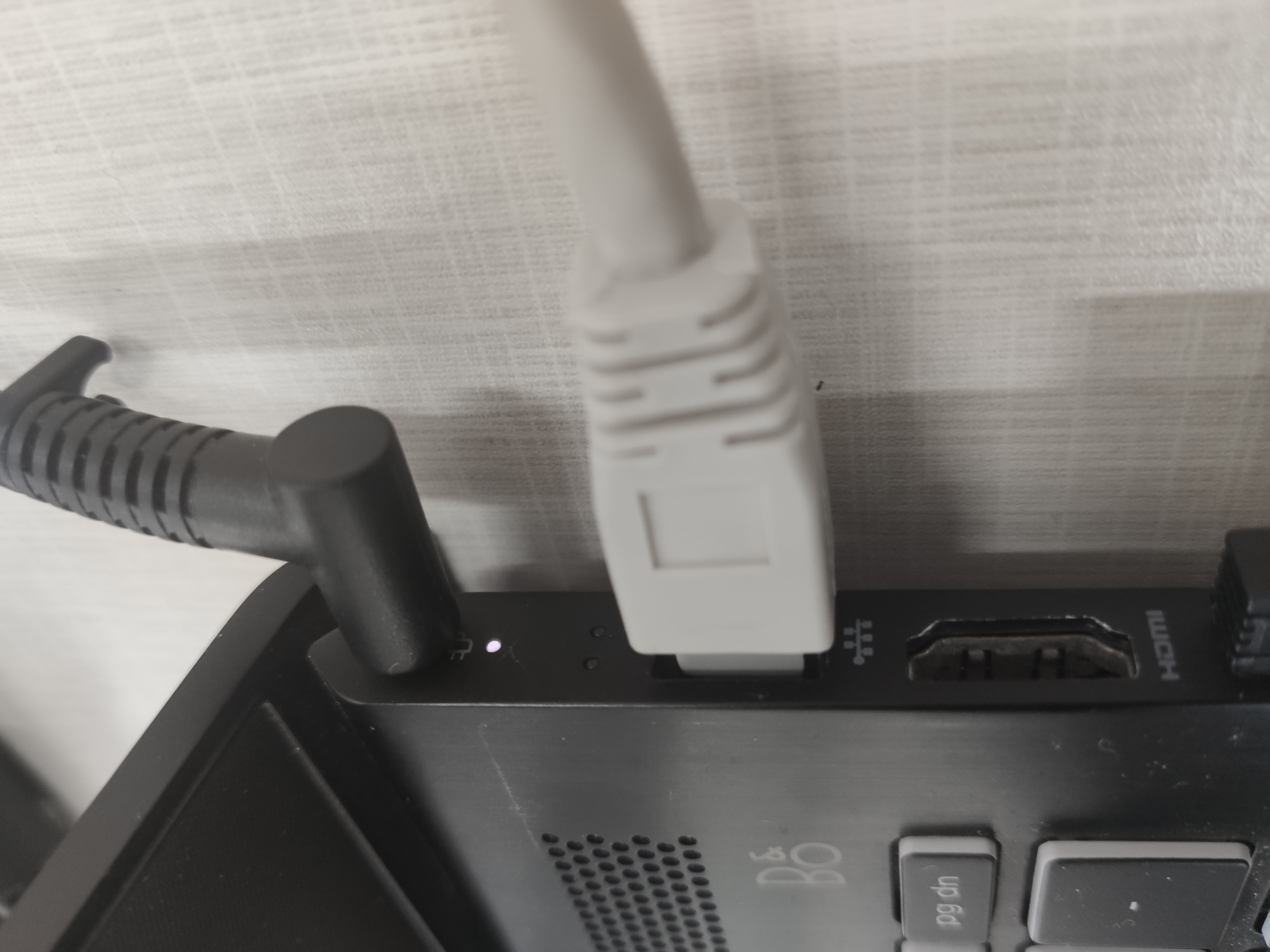

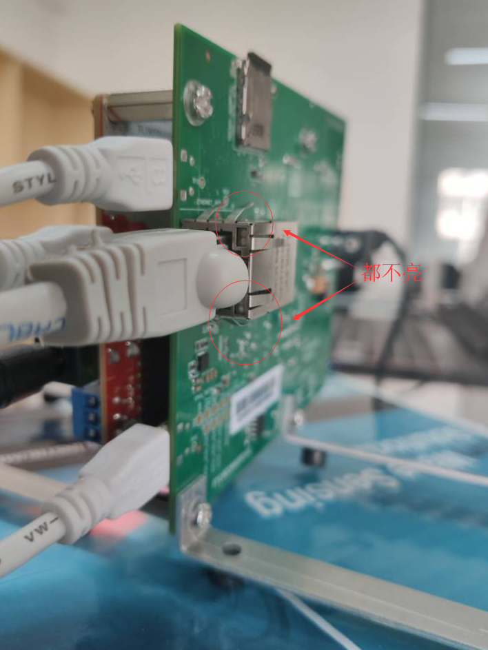

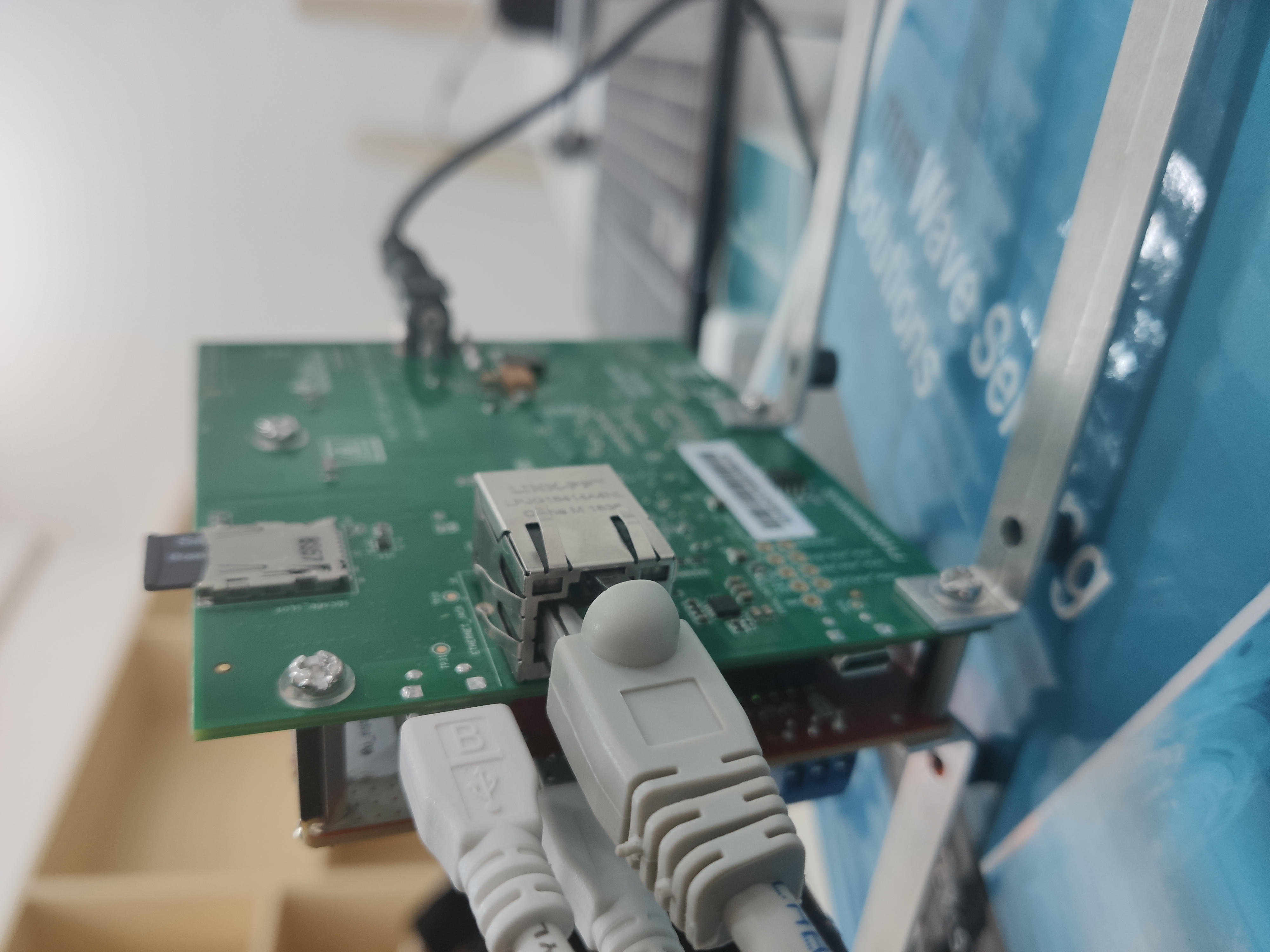

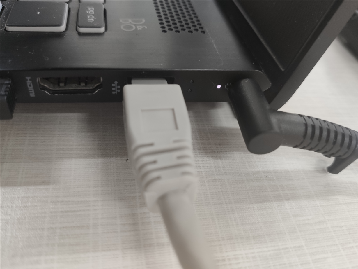

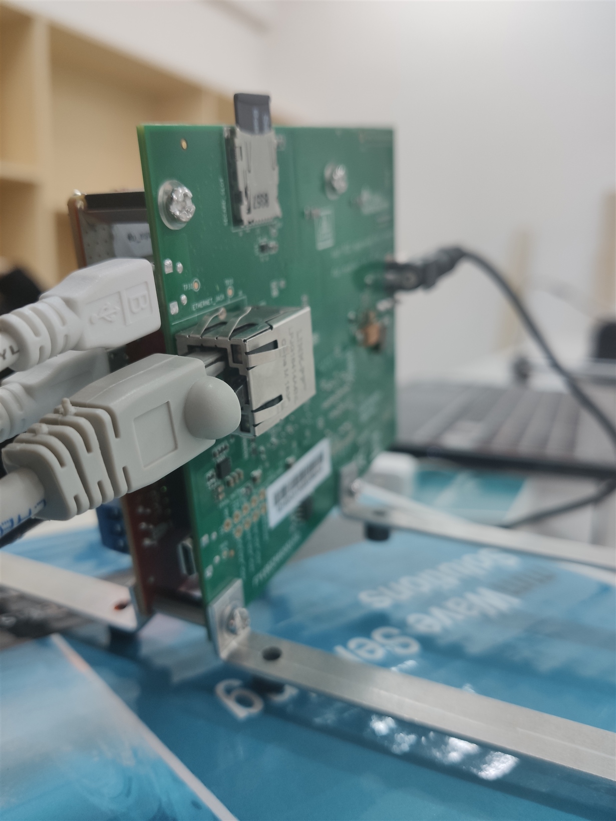

    4.我想确认是否是DCA1000网口接触不良导致的,因为网口出的灯从来没有亮过;

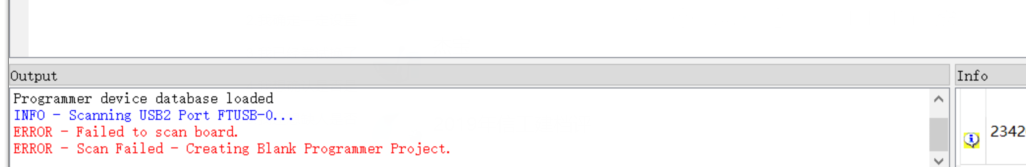

    5.我还想确认是否是DCA1000内部FPGA存在问题,因为我想尝试重新烧录FPGA内部程序,我下载了user guide告诉我的软件,在用该软件连接板子时报错如下:
    请给我一些更精确的答复,谢谢!
  • 你好,
    这个帖子我也都看过了,
    帖子中提问者的以太网口至少有一个灯是亮的,
    而我的以太网口不论是绿灯还是橙灯都没有亮过,
    连接到电脑上的灯也是不亮的,
    帖子中的解决方法我们都试过了也都无效,
    我想确认是否是这块板子的网口接触不良导致我的电脑认为物理连接都没有连上。

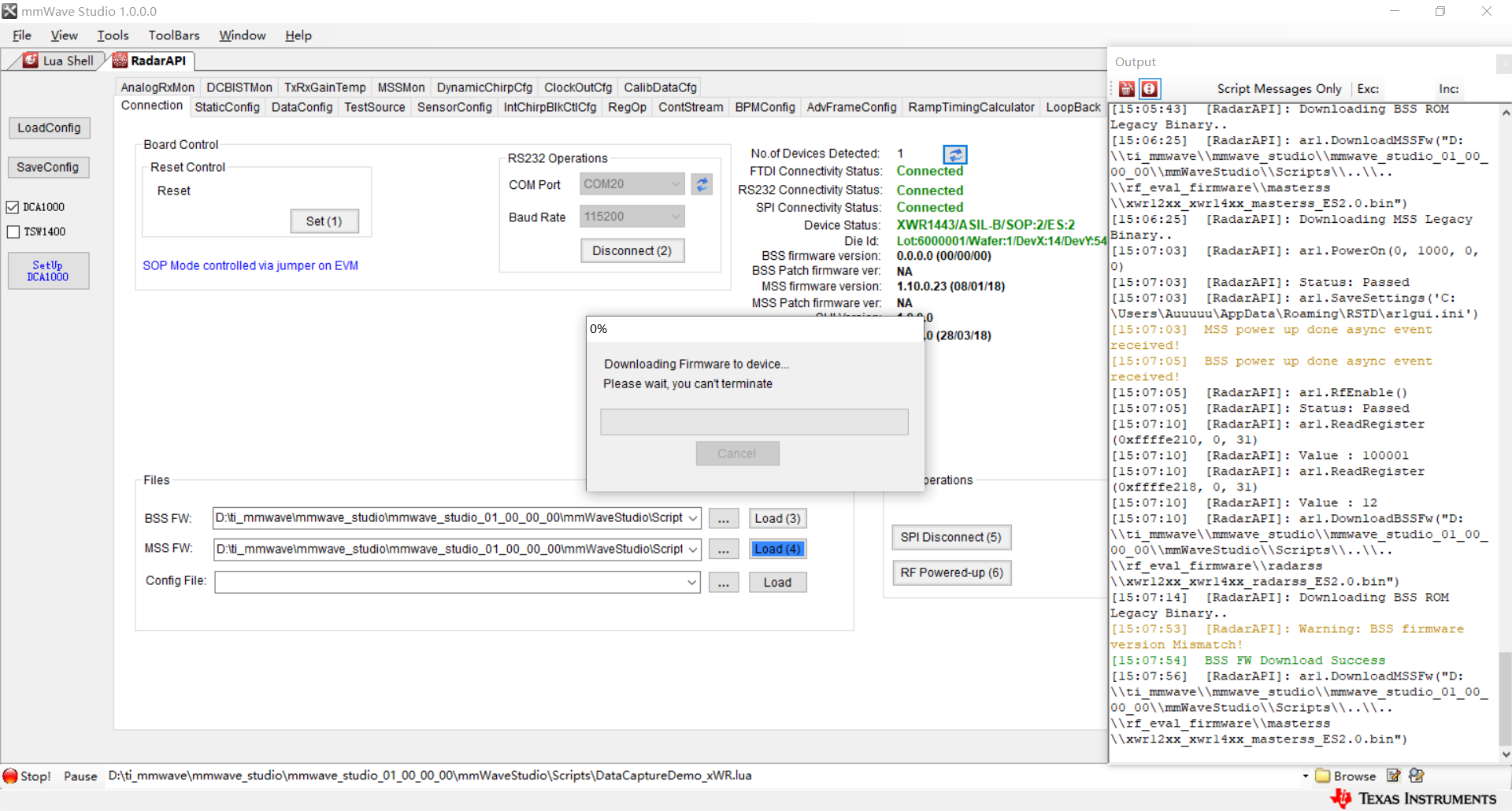

  • 我在烧录lua时就一直卡在这里一个小时没有动过,最后还是用任务管理器强制结束任务。

  • 这里选择 FTUSB-1才能扫描到
