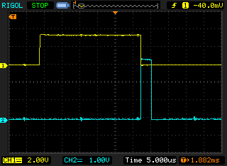

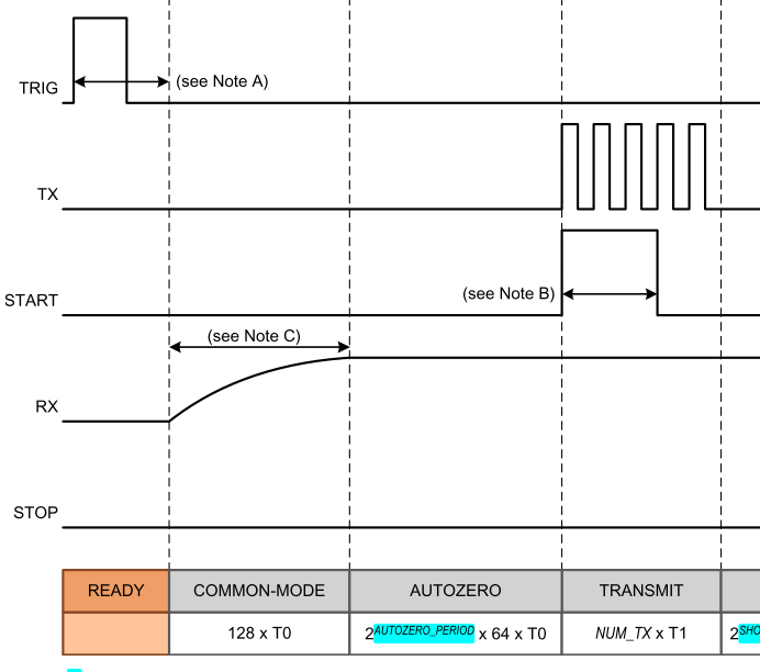

在使用TDC1000时,Short TOF 模式,官方的文档给的示意图是这样的
可以看到,触发与TX脉冲和Start信号之间应有可编程的间隔,然而我自己使用时,波形如下:
上图黄色为触发信号,蓝色为Start信号

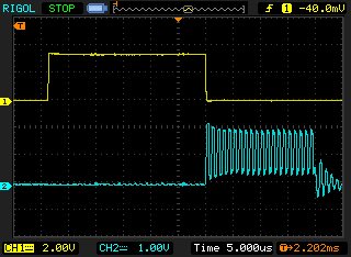

上图黄色为触发信号,蓝色为TX脉冲
它们和官方文档的描述有出入,请问是怎么回事,谢谢
  • 您好,这个时间间隔在datasheet page26的8.4.5.2 TX/RX Measurement Sequencing and Timing有介绍,即Note A 这部分的时间T=3T0+2T1或者T=3T0+3T1. 举例ƒCLKIN = 8 MHz,分频系数TX_FREQ_DIV 为8, 那么周期=1/8Mhz=125ns
    , T1=1uS, 因此START和触发Triger之间的时间差为3*125ns+2*1us=2.375uS或者3*125ns+3*1us=3.375us。
    During resynchronization, the trigger and START edges are aligned to the negative edge of the external clock.
    The time between trigger and START is equal to 3 T0 periods plus 2 or 3 T1 periods, depending on the phase
    between the received trigger pulse and the external clock. For example, if ƒCLKIN = 8 MHz and TX_FREQ_DIV =
    0h2 (divide-by-8), the period T0 is 125 ns and the period T1 is 1 µs, resulting in a time of 2.375 µs or 3.375 µs
    between the received trigger signal and the generated START pulse.
  • 可是我上面给的波形,刻度是5us/格,明显Trigger和START时间差达不到您说的2.375us或3.375us这么大。
