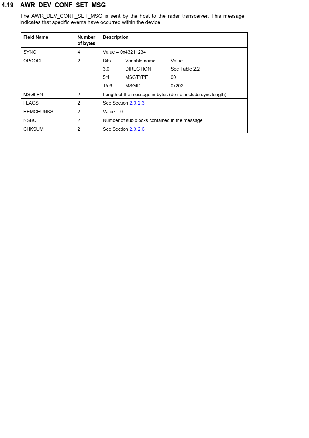

怀疑AWR1xxx Radar Interface Control Document描述错误?
可以发现两者是不对应的,MSGID对应的是AWR_DEV_CONF_SET_MSG应该是0x1234 0x4321以及是COMMAND类型,但实际得到的log信息如下,
是文档错误还是log错误?
[19:22:09:044]: Device [0] Host IRQ High
[19:22:09:045]: Device [0] [WR]0x5678 0x8765 0xFFFF 0xFFFF 0xFFFF 0xFFFF 0xFFFF 0xFFFF
[19:22:09:047]: Device [0] Host IRQ Low
[19:22:09:048]: Device [0] [RD]0xDCBA 0xABCD
[19:22:09:048]: Device [0] [RD]0x8096[与文档对应不上,0x202的MESGTYPE:00 CMD而非01 RESPONSE] 0x000E 0x800C 0x0000 0x0000 0xFF4E
