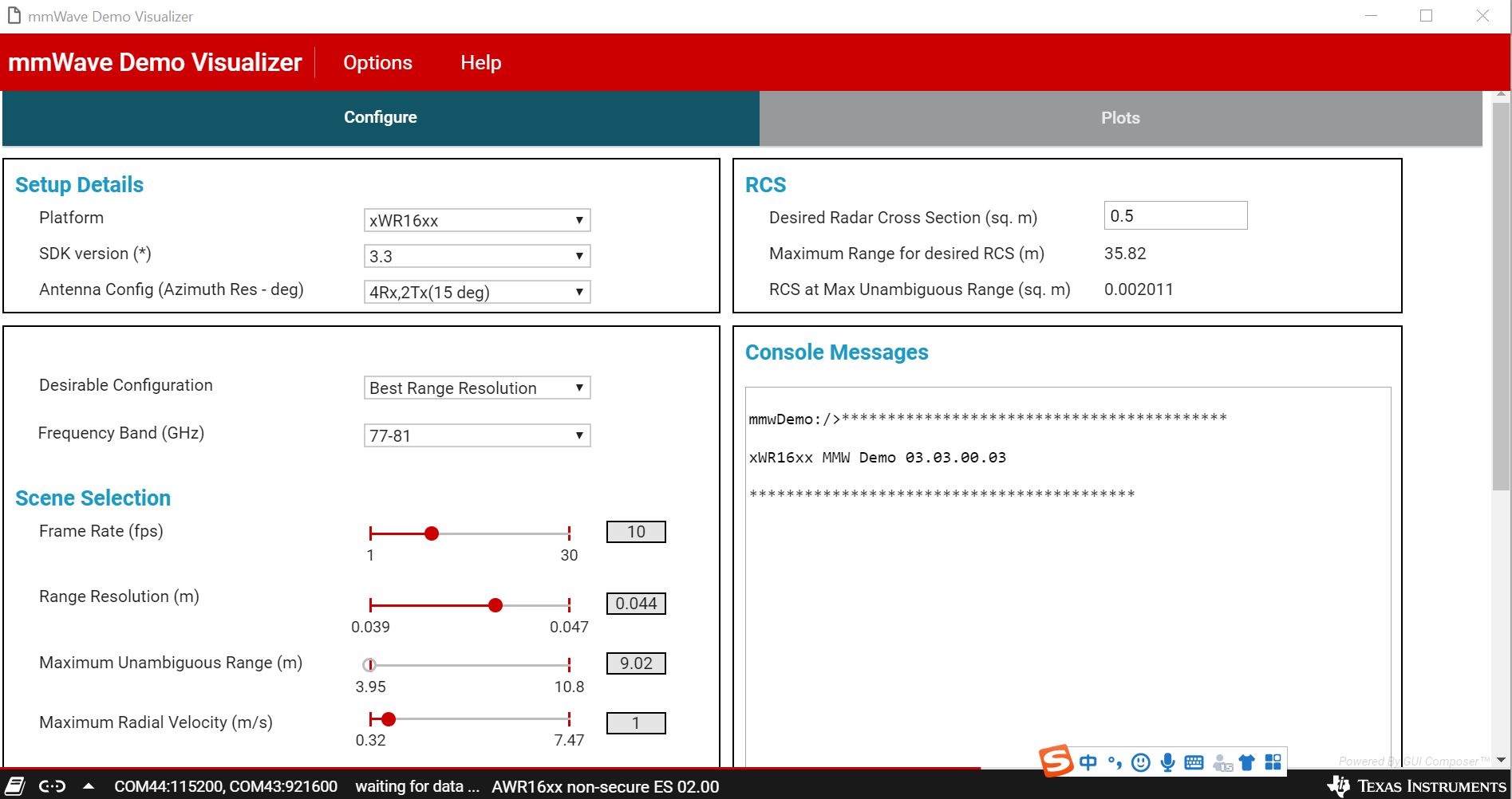

Hello TI:
the mmWave Demo visualizer is pending on "waiting for data" when try connect visualizer with AWR1642BOOST.  Is there any suggestion?  thanks.
Chip Version: xWR1642 ES2.0
SDK Version: mmwave_sdk_03_03_00_03
mmWave_Demo_Visualizer: offline version 3.3.0
note: I got the AWR1642 BOOST from TI first time, the SDK version in AWR1642BOOST is SDK2.x, the Visualizer(offline version 3.3.0) also can not connect with  AWR1642BOOST(SDK2.x).   so I flashed AWR1642BOOST with xwr16xx_mmw_demo.bin from mmwave_sdk_03_03_00_03\packages\ti\demo\xwr16xx\mmw\

    after send config to mmwave device, there are no data in plots GUI. any suggestion? thanks.,
    console logs:
    mmwDemo:/>clutterRemoval -1 0
    Done
    mmwDemo:/>compRangeBiasAndRxChanPhase 0.0 1 0 1 0 1 0 1 0 1 0 1 0 1 0 1 0
    Done
    mmwDemo:/>measureRangeBiasAndRxChanPhase 0 1.5 0.2
    Done
    mmwDemo:/>aoaFovCfg -1 -90 90 -90 90
    Done
    mmwDemo:/>cfarFovCfg -1 0 0.25 9.71
    Done
    mmwDemo:/>cfarFovCfg -1 1 -7.49 7.49
    Done
    mmwDemo:/>CQRxSatMonitor 0 3 4 127 0
    Done
    mmwDemo:/>CQSigImgMonitor 0 63 8
    Done
    mmwDemo:/>analogMonitor 0 0
    Done
    mmwDemo:/>lvdsStreamCfg -1 0 0 0
    Done
    mmwDemo:/>sensorStart
    Done
  • 烧写固件之后有没有重新复位一下开发板。
    核对一下步骤:
    1. Flash mmw demo 'xwr16xx_mmw_demo.bin' (<mmwave-sdk>\pacakges\ti\demo\xwr16xx\mmw\) to device using Uniflash tool. Connect SOP2 jumoer on AWR1642 EVM before flashing it.
    2. Remove SOP2 jumper and reset the board.
    3. Connect HyperTerminal/TeraTerm to COM port enumerated as 'XDS110 Class Application/User UART' in device manager at 115200 Buadrate.
    4. After connection if you hit enter, mmw demo should print prompt message 'mmwDemo:>'
  • 按照教程操作之后,uniflash软件里下载好bin文件和设置好端口后,打开mmwave_demo_visualizer网页后设置端口版本等参数后,可以连接上设备,但是一直处于等待数据状态,在点击send config to mmwave device按钮后无反应,有没有具体操作说明可以了解一下,
