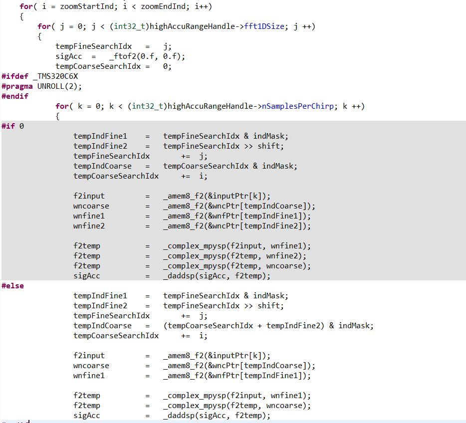

请教level_sensing例程里关于Zoom FFT的计算方法
大家好,
最近在看level_sensing就是高精度测距例程的代码,关于Zoom FFT的代码没有看明白,没有找到旋转因子抽取的规律,也就不明白提高距离精度或者分辨率的根本原因。请大家帮忙看看,感谢!
具体的代码从下面c文件的251行开始:

	/* zoom in FFT: assuming always size of fft1DSize x fft1DSize */
	zoomStartInd	=	coarseRangeInd - highAccuRangeHandle->numRangeBinZoomIn;
	zoomEndInd		=	coarseRangeInd + highAccuRangeHandle->numRangeBinZoomIn;
	indMask			=	highAccuRangeHandle->fft1DSize - 1;
	shift			=	30 - _norm(highAccuRangeHandle->fft1DSize);
	inputPtr		=	(__float2_t *)highAccuRangeHandle->inputSig;
	wncPtr			=	(__float2_t *)highAccuRangeHandle->wnCoarse;
	wnfPtr			=	(__float2_t *)highAccuRangeHandle->wnFine;
	max				=	0.f;
	itemp			=	0;
	currP			=	0.f;
	prevP			=	0.f;
	maxNextP		=	0.f;
	maxPrevP		=	0.f;
	for( i = zoomStartInd; i < zoomEndInd; i++)
		for( j = 0; j < (int32_t)highAccuRangeHandle->fft1DSize; j ++)
			tempFineSearchIdx	=	j;
			sigAcc  =	_ftof2(0.f, 0.f);
			tempCoarseSearchIdx	=	0;
#ifdef _TMS320C6X
#pragma UNROLL(2);
#endif
			for( k = 0; k < (int32_t)highAccuRangeHandle->nSamplesPerChirp; k ++)
#if 0
				tempIndFine1	=	tempFineSearchIdx & indMask;
				tempIndFine2	=	tempFineSearchIdx >> shift;
				tempFineSearchIdx		+=	j;
				tempIndCoarse	=	tempCoarseSearchIdx & indMask;
				tempCoarseSearchIdx		+=	i;
				f2input			=	_amem8_f2(&inputPtr[k]);
				wncoarse		=	_amem8_f2(&wncPtr[tempIndCoarse]);
				wnfine1			=	_amem8_f2(&wnfPtr[tempIndFine1]);
				wnfine2			=	_amem8_f2(&wncPtr[tempIndFine2]);
				f2temp			=	_complex_mpysp(f2input, wnfine1);
				f2temp			=	_complex_mpysp(f2temp, wnfine2);
				f2temp			=	_complex_mpysp(f2temp, wncoarse);
				sigAcc			=	_daddsp(sigAcc, f2temp);
#else
				tempIndCoarse	=	(tempCoarseSearchIdx + tempIndFine2) & indMask;
#endif
		shift			=	highAccuRangeHandle->log2fft1DSize;
		inputPtr		=	(float *)highAccuRangeHandle->inputSig;
		wncPtr			=	(float *)highAccuRangeHandle->wnCoarse;
		wnfPtr			=	(float *)highAccuRangeHandle->wnFine;
		max				=	0.0;
		itemp			=	0;
				sigAccReal  =	0.f;
				sigAccImag  =	0.f;
					finputReal		=	inputPtr[2 * k];
					finputImag		=	inputPtr[2 * k + 1];
					tempReal		=	wncPtr[2 * tempIndCoarse + 1] * finputReal - wncPtr[2 * tempIndCoarse] * finputImag;
					tempImag		=	wncPtr[2 * tempIndCoarse] * finputReal + wncPtr[2 * tempIndCoarse + 1] * finputImag;
					sigAccReal		+=	wnfPtr[2 * tempIndFine1 + 1] * tempReal - wnfPtr[2 * tempIndFine1] * tempImag;
					sigAccImag		+=	wnfPtr[2 * tempIndFine1] * tempReal + wnfPtr[2 * tempIndFine1 + 1] * tempImag;
				ftemp				=	sigAccReal * sigAccReal + sigAccImag * sigAccImag;
				if( max < ftemp)
					max				=	ftemp;
					fineRangeInd	=	itemp;
				itemp++;
		fdelta			=	(highAccuRangeHandle->maxBeatFreq) / ((float)highAccuRangeHandle->fft1DSize * (float)highAccuRangeHandle->fft1DSize);
		freqFineEst		=	fdelta * (float)(zoomStartInd * highAccuRangeHandle->fft1DSize + fineRangeInd);
		*estRange		=	(freqFineEst * (float)3e8 * highAccuRangeHandle->chirpRampTime) / (2.f * highAccuRangeHandle->chirpBandwidth);
