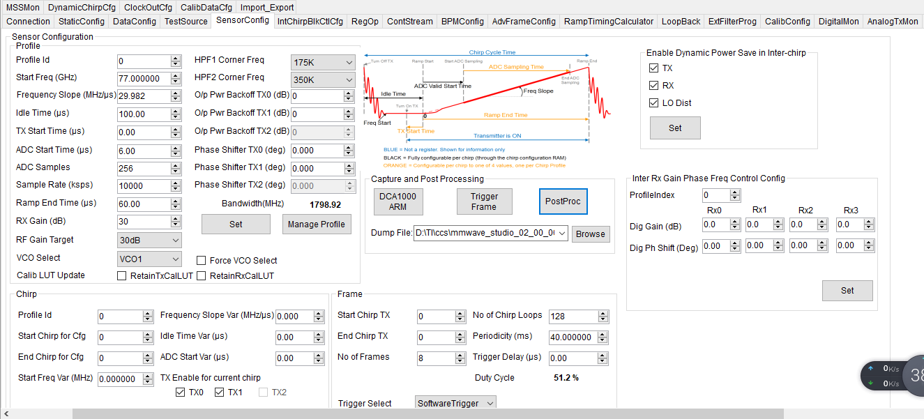

mmwave studio related parameters
There are two problems:
The first is that I set the parameters on the mmwave studio software as shown in Figure 1 below. The bandwidth displayed on this interface is 1798.92 MHz, but after the data collection is completed, I pass the postproc. 0.7675GHz, the two show inconsistency. What is the reason for this and how should I change the parameters to make my bandwidth larger.
The second is that I set the parameters on the mmwave studio software. As shown in Figure 1, I think a chirp time should be 60us, but after I pass the postproc, the chirp signal duration obtained in the interface displayed in matlab is shown in Figure 3. It is 25us. This is also verified in the time domain diagram of the chirp signal I drew after analyzing the data. The result is 25us. This does not match the parameters set, how can I understand this difference.
Thank you and look forward to your reply
