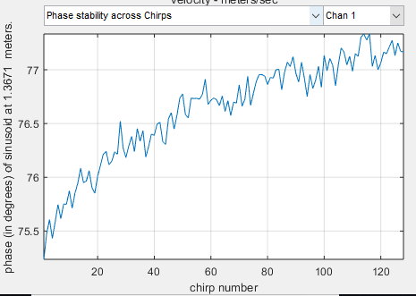

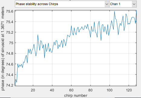

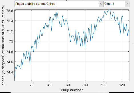

I used the default parameters of mmwavestudio in the acquisition to measure a static target. When I want to extract its tiny deformation information, I need to convert it through his phase information. But I found that there is a phase transition between frames. This jump will affect the calculation of small deformations. How do I set parameters to narrow this phase change. As shown in the figure, there is a large difference between the last phase of the first frame of IWR1642 (75.1 °) and the initial phase of the second frame (74.2 °).
