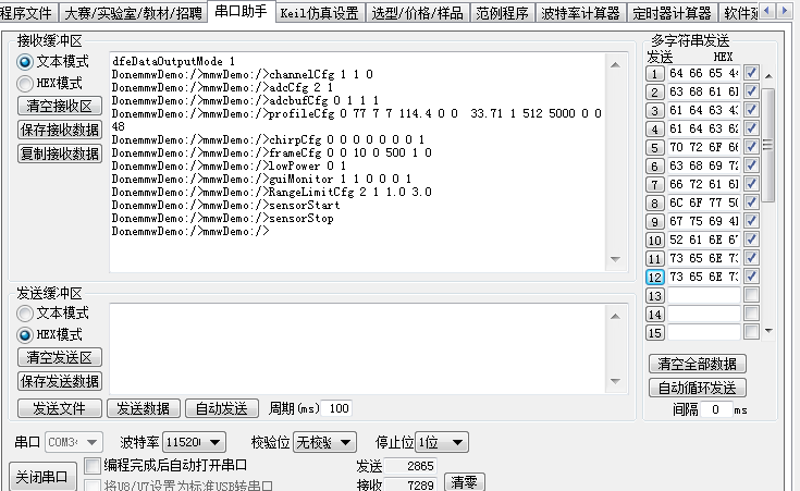

我使用IWR1642 Boost,运行mmwave_industrial_toolbox_4_2_0__win里面的16xx_high_accuracy例程,我用串口工具发送CLI命令到IWR1642,发送完high_accuracy_demo_16xx.cfg里的命令后程序正常运行,然后我用串口发送"sensorStop"命令,CCS上提示mmWave_stop失败,串口操作界面和CCS提示信息如下:

[Cortex_R4_0] Error: MMWDemoMSS mmWave Stop failed [Error code -204087950]
[C674X_0] Error: Asynchronous Event SB Id 15 not handled
请问怎么解决这个问题?
