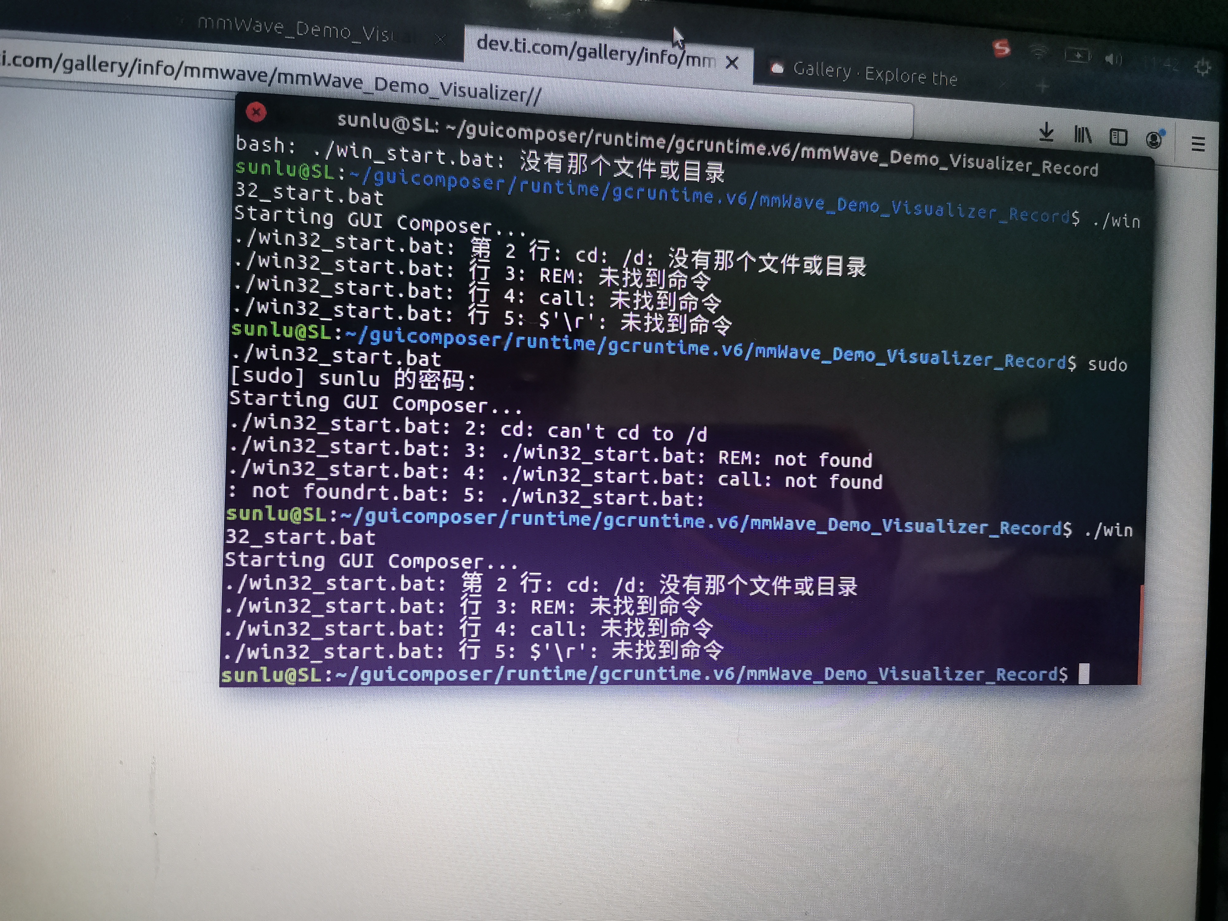

linux系统下mmWave Demo Visualizer 的beat版本如何打开?
在linux系统下,想使用mmWave Demo Visualizer 的beat版本记录雷达检测目标的可直观看的.csv数据,但是现在运行不了mmWave Demo Visualizer,然后我在安装路径下找到win32_start.bat在终端运行也报错,求解答。
  • win32_start.bat这是在windows下用的。
  • 那在linux下怎么用呢?怎么才能打开mmWave Demo Visualizer的beat版本呢?
  • 有根据安装包里的\install_image_mmWave_Demo_Visualizer\mmWave_Demo_Visualizer\docs\readme.txt文件中的步骤安装吗?
  • 有一个install_image_mmWave_Demo_Visualizer的压缩包,需要在linux 系统下解压然后安装吗?我没有找到您说的readme。txt

    **Linux (64 bit) Installation Instructions**
    To install all prerequisites for your application:
      * open a terminal window
      * cd into the application folder (which is located in the guicomposer runtime folder)
    The following commands need to be executed from the Terminal app with this folder as the working directory in order
    to enable proper execution of the application:
         sudo ln -sf /lib/x86_64-linux-gnu/libudev.so.1 /lib/x86_64-linux-gnu/libudev.so.0
         sudo apt-get install lib32stdc++6 libc6-i386 libusb-1.0-0-dev:i386
         sudo chmod -R a+rwx ../..
         cd linux/TICloudAgentHostApp
         sudo ./install.sh --install
    To run your application, cd into the application folder and enter the following command:
         ./launcher.lnx
    If the application needs to access to your PC's serial ports, you may need to configure permissions to access
    the serial ports by adding yourself to the group that owns the /dev/usbPortName
    To find out what group the serial port ttyACM0 is owned by, do
         ls -l /dev/ttyACM0
    Assuming the group is named dialout, add yourself to that group by using the sudo adduser command:
         sudo adduser my_user_name dialout
    You may also need to change the permissions on the USB port to permit read / write access for anyone.
         sudo chmod 666 /dev/ttyACM0
