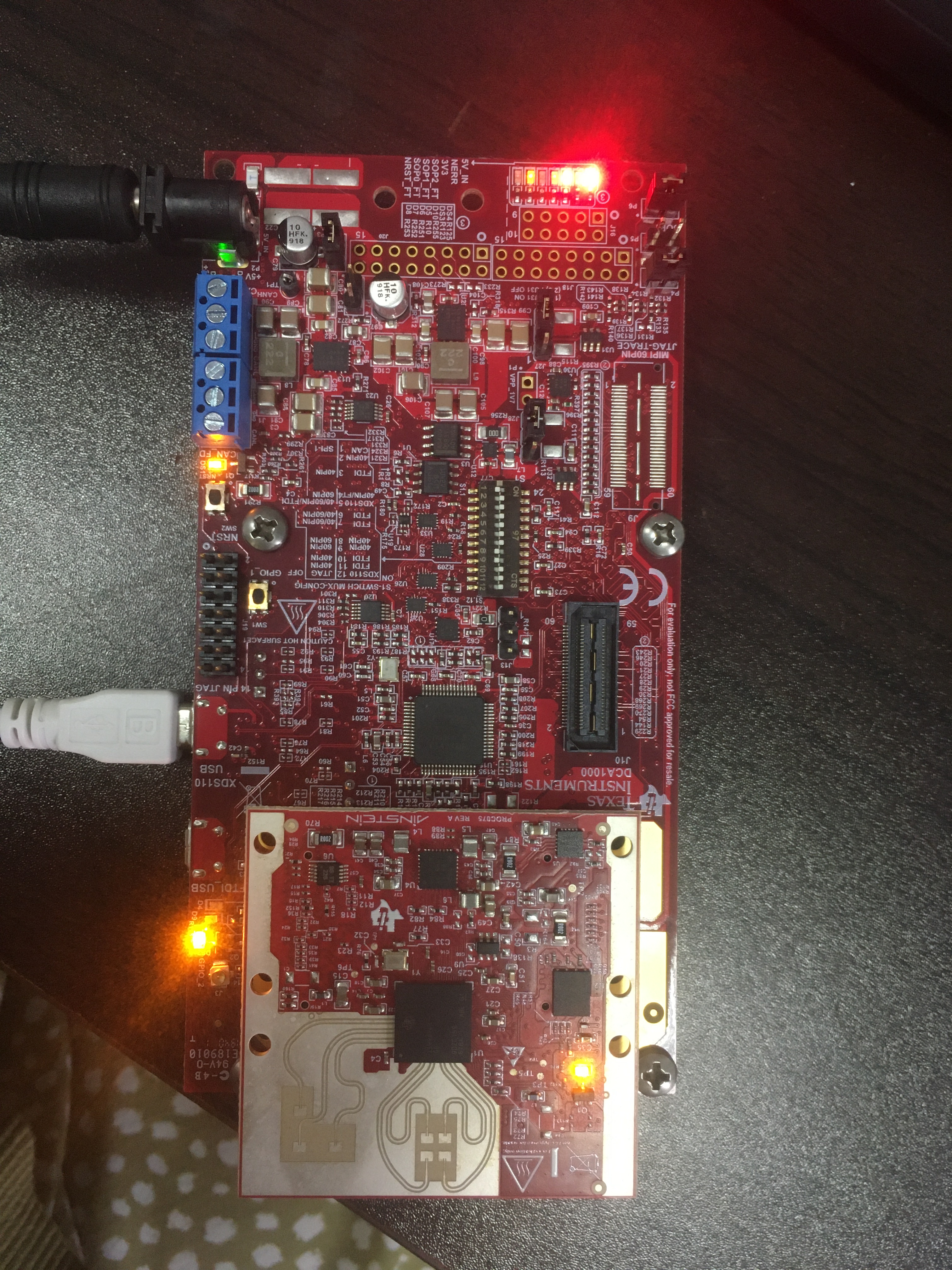

您好:
   我按照下图接上硬件,在调试模式下中,选择加载xwr64XXODS_MMW_MSS.xer4f文件后运行出现错误,错误类型如下
Cortex_R4_0: Trouble Writing Memory Block at 0x0 on Page 0 of Length 0x3c: (Error -1065 @ 0x0) Unable to access device memory. Verify that the memory address is in valid memory. If error persists, confirm configuration, power-cycle board, and/or try more reliable JTAG settings (e.g. lower TCLK). (Emulation package 8.4.0.00006) Cortex_R4_0: File Loader: Verification failed: Target failed to write 0x00000000 Cortex_R4_0: GEL: File: G:\ccs930\workspace\ods_point_cloud_68xx_hwa\Debug\xwr64xxODS_mmw_mss.xer4f: Load failed.
硬件连接图:
出现这种问题是软件问题,还是硬件连接问题;还有如何解决这个问题。谢谢!
  • 你好。
    你现在的SOP模式是flash mode (101)。如果需要CCS下载代码测试,请先烧写相应mmwave sdk里面mmwave_sdk\packages\ti\utils\ccsdebug目录下对于的ccsdebug bin文件。
    然后修改SOP为function mode(001),再连接CCS下载。
