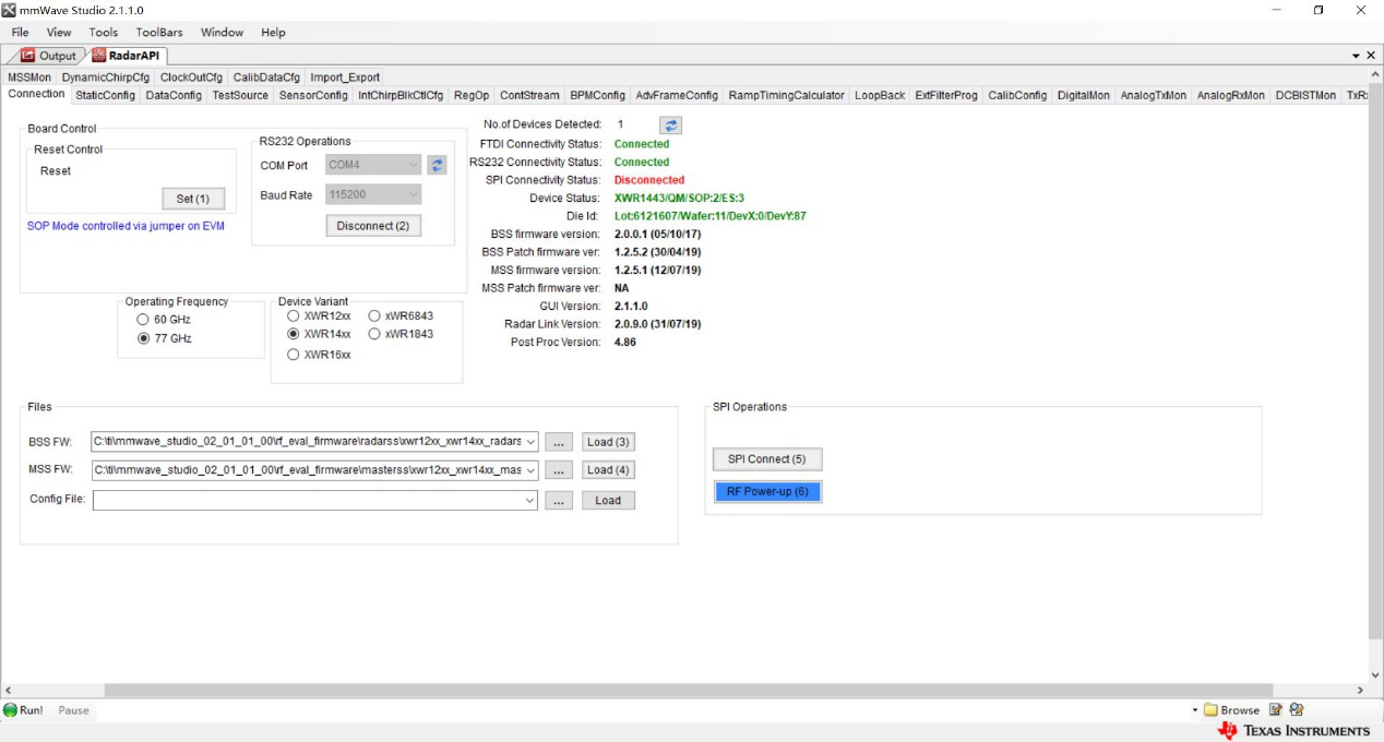

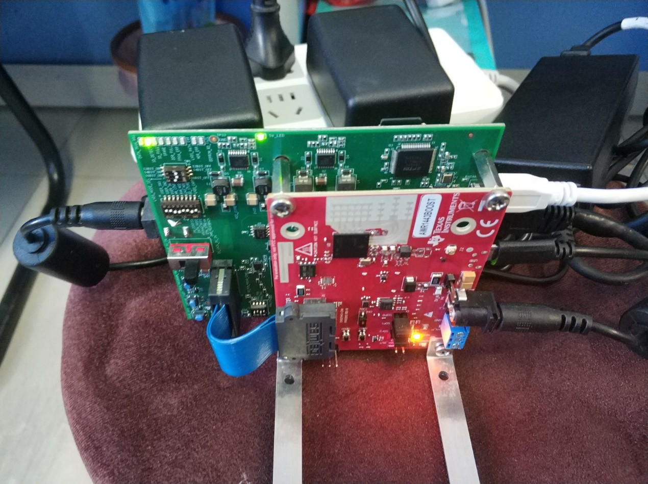

Hello there,
Follow the [DCA1000EVM Quick Start Guide] file, the SPI Connect step is wrong,the problem was not solved using the following two solutions.
1. Use UniFlash software to format SFLASH;
2. Use the low version software mmwave_studio_01_00_00_00.
Hardware connection picture:
Screenshot of the RadarAPI window of the mmWave Studio 02.01.01.00 software interface:
mmWave Studio 02.01.01.00 software interface Output window log

[14:45:50]  Device Status : XWR1443/QM/SOP:2/ES:3
[14:45:50]  [RadarAPI]: ar1.SaveSettings('C:\Users\6\AppData\Roaming\RSTD\ar1gui.ini')
[14:45:55]  [RadarAPI]: ar1.DownloadBSSFw("C:\\ti\\mmwave_studio_02_01_01_00\\rf_eval_firmware\\radarss\\xwr12xx_xwr14xx_radarss.bin")
[14:45:55]  [RadarAPI]: Downloading BSS Patch RPRC Binary..
[14:46:03]  [RadarAPI]: ar1.GetBSSFwVersion()
[14:46:03]  [RadarAPI]: BSSFwVersion:(02.00.00.01 (05/10/17))
[14:46:03]  [RadarAPI]: ar1.GetBSSPatchFwVersion()
[14:46:03]  [RadarAPI]: BSSPatchFwVersion:(01.02.05.02 (30/04/19))
[14:46:05] [RadarAPI]: ar1.DownloadMSSFw("C:\\ti\\mmwave_studio_02_01_01_00\\rf_eval_firmware\\masterss\\xwr12xx_xwr14xx_masterss.bin")
[14:46:05]  [RadarAPI]: Downloading MSS RPRC Binary..
[14:46:23]  [RadarAPI]: ar1.GetMSSFwVersion()
[14:46:23]  [RadarAPI]: MSSFwVersion:(01.02.05.01 (12/07/19))
[14:46:36]  [RadarAPI]: ar1.PowerOn(0, 1000, 0, 0)
[14:46:36]  Status: Failed, Error Type: RESP TIMEOUT
[14:46:40]  MSS Power Up async event was not received!
[14:47:22]  [RadarAPI]: ar1.PowerOn(0, 1000, 0, 0)
[14:47:22]  Status: Failed, Error Type: RESP TIMEOUT
[14:47:27]  MSS Power Up async event was not received!
