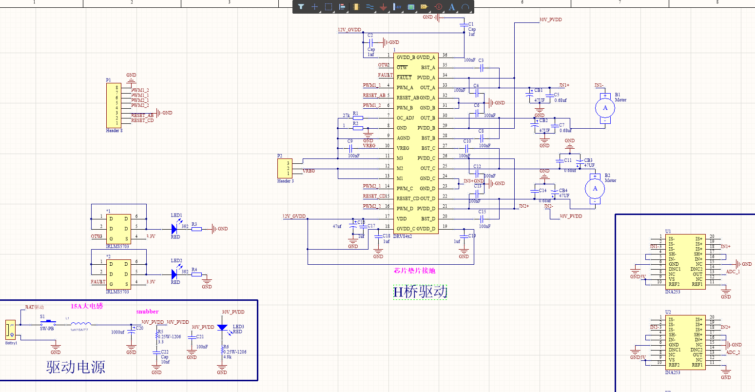

上电12V_gvdd之后 otw灯亮报错,24_pvdd上电之后,resetab接高电平,工作模式为模式4.给pwmA_1通pwm信号,此时fault灯亮起,芯片输出outa、b(不接负载)处的电压都是12.4V,改变pwm信号 芯片的输出没有任何反应,芯片没有发热。附上本人参考官方EDA测试版的原理图,求大神指教

I see some very large capacitors (47uf) on the output lines before the motor connections. This high of capacitance can cause an OCP event.
Can you try removing all of these capacitors from output to GND and test again?
