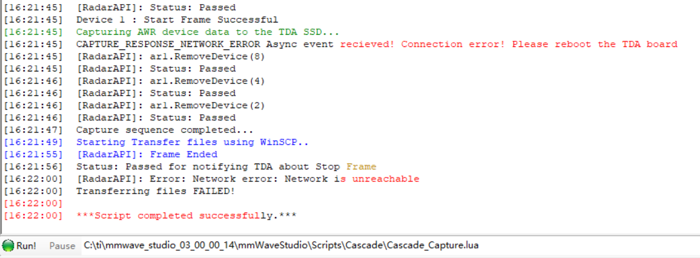

上午采集数据时还没有问题,但下午改了Cascade_Configuration_TestSource.lua中的两个参数后数据采集出现问题
前面配置没有报错,但执行Cascade_Capture后出错

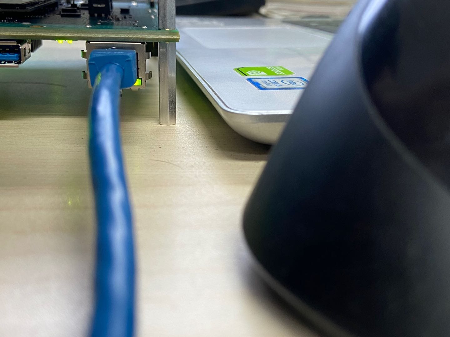

将参数改回后仍然报错,检查网口发现灯只亮了一个,请问这是不是硬件出问题了,网口无法下行数据
  • 请看下面的FAQ是否有帮助?
    How to proceed further if the following error is received :"CAPTURE_RESPONSE_NETWORK_ERROR Async event recieved! Connection error! Please reboot the TDA board".
    This usually comes when the TDA2xx capture card is out of network. Try to ping the TDA card from your PC and vice versa to ensure it is connected to the network. If not, please follow the user guide to establish connection.
    另外,请看一下给板子的供电电流是否足够?
  • 重启后再次采集问题解决。
