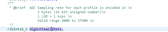

程序中注释可设置的adc采样率范围是2Msps~37.5Msps,不能比2Msps更低了吗??

是的。在ti\mmwave_dfp_01_02_05_01\docs\mmWave-Radar-Interface-Control.pdf里,你可以找到下面的内容:
PF DIGITAL OUTPUT SAMPLING RATE
2 ADC Sampling rate for this profile is encoded in 2 bytes (16 bit unsigned number)
1 LSB = 1 ksps
Valid range:
xWR1xxx and IWR6843 devices: 2000 to 37500 (Max 15MHz IF bandwidth)
