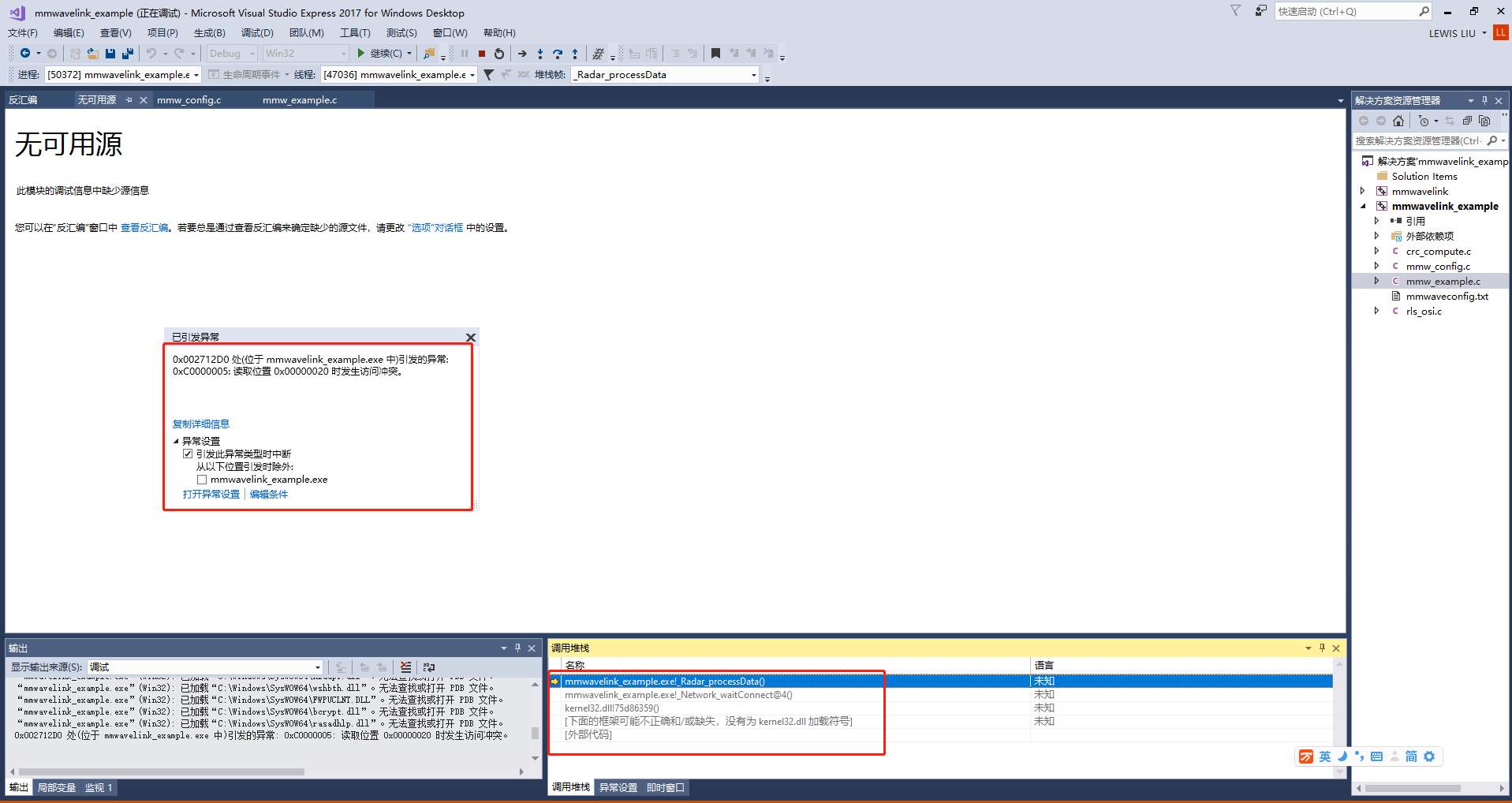

HI, ALL
目前我使用mmwave_dfp_02_01_05_03自带mmWaveLink_Cascade_Example来调试级联雷达板(mmwave_dsp_evm+mmwave_rf_evm)中的雷达配置过程,但是 在运行到ethernetConnect时发生断错误。  我尝试跟踪到ethernetConnect时,发现此函数是mmwl_port_ethernet.dll提供的, 无法跟踪到代码中。  此问题我应该如何解决?

用例配置:
* USER CONFIGURABLE DEFINITIONS
/* TDA2xx IP Address */
static char mmwl_TDA_IPAddress[] = "192.168.3.180";
/* TDA2 Configuration Port */
static unsigned short mmwl_TDA_ConfigPort = 5001U;
/* Capture Directory */
static char mmwl_TDA_CaptureDirectory[] = "/mnt/ssd/MMWL_Capture";
报错接口:
int MMWL_TDAInit()
int retVal = RL_RET_CODE_OK;
int timeOutCnt = 0;
/* Register Async event handler with TDA */
retVal = registerTDAStatusCallback((TDA_EVENT_HANDLER)TDA_asyncEventHandler);
if (retVal != RL_RET_CODE_OK)
printf("ERROR: Registering Async event handler with TDA failed with error %d \n\n",
retVal);
return -1;
else
printf("INFO: Registered Async event handler with TDA \n\n");
mmwl_bTDA_CaptureCardConnect = 0U;
/* Connect to the TDA Capture card */
printf("INFO: call ethernetConnec !\n\n");
retVal = ethernetConnect(mmwl_TDA_IPAddress, mmwl_TDA_ConfigPort, mmwl_TDA_DeviceMapCascadedAll);
printf("INFO: ethernetConnec ! retVal = %d\n\n", retVal);
printf("ERROR: Connecting to TDA failed with error %d. Check whether the capture card is connected to the network! \n\n",
retVal);
return -1;
动态静路径:
mmwl_port_ethernet.dll位于mmwave_dfp_02_01_05_03\ti\example\platform\mmwl_ethernet目录下。
  • 你好,
    请问你的电脑上是否有防火墙或者杀毒软件?如果有,能否关闭后尝试一下?
  • HI, Chris Meng
    我这边的确安装了火绒,关闭后测试效果仍然是一样的, 仍然是在调用ethernetConnect出现段错误。用例打印如下:
    ================= mmWaveLink Example Application ====================
    Device map 32 : CAPTURE_RESPONSE_ACK Async event recieved with status 0
  • Lewis,
    默认mmw_example.c里TDA2x的IP地址如下。你的代码修改为192.168.3.180后,请问你的PC的IP地址设置的是多少?是否在同一个网段?
    static char mmwl_TDA_IPAddress[] =                            "192.168.33.180";
    请注意mmwave_dfp_02_01_05_03支持的芯片是AWR2243 ES1.0。如果你的MMWCAS-RF-EVM上的AWR2243是ES1.1的,请下载最新的DFP包来支持。
