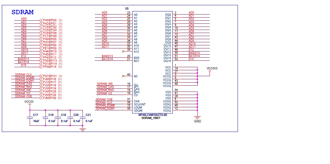

TI的大侠们,,我用的LM3s9b96,SDRAM为什么初始化过不了
以下是我的初始化过程,

 bRetcode = SDRAMInit(1, (EPI_SDRAM_CORE_FREQ_0_15 | EPI_SDRAM_FULL_POWER | EPI_SDRAM_SIZE_64MBIT),1024);
 return(bRetcode);
仿真看了下,SDRAMInit()这个函数,读写SDAM验证不过:如下
    g_pusEPIMem[0] = 0xABCD;
    g_pusEPIMem[1] = 0x5AA5;
    // Read back the patterns we just wrote to make sure they are valid.  Note
    // that we declared g_pusEPIMem as volatile so the compiler should not
    // optimize these reads out of the image.
    if((g_pusEPIMem[0] == 0xABCD) && (g_pusEPIMem[1] == 0x5AA5))
纠结了好久,没发现问题,望指点下。。。,谢谢了!
