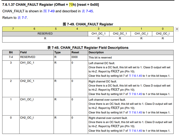

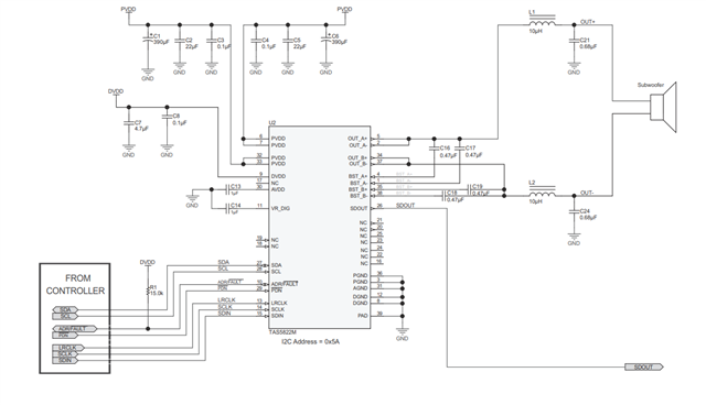

An error occurred in TAS5822 when using PBTL mode. The value read from the Ox70 register is 0000 0001. Under what circumstances might this error occur? Thanks,jenkey zhu.
