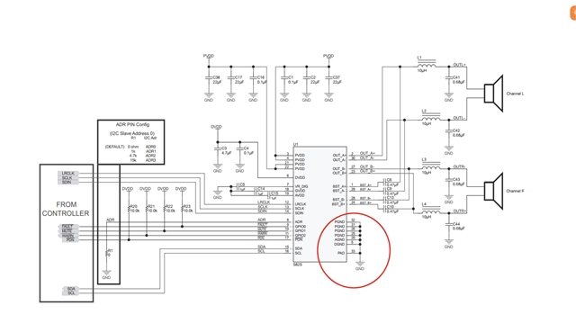

如下图所示,模拟地与数字地是否需要分开,以达到更好的音频性能?
第一个链接都打不开了,我可以把之前的回复复制给你。
but about the GND, they need to be connect together.
section 10.4 in the datasheet is our layout recommendation for the tas5825.
