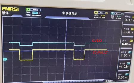

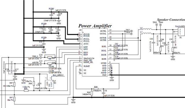

The production line found that the TPA3138 had no audio output. After investigating the cause, it was discovered that the GVDD was only 4.3V. Under normal circumstances, GVDD should be synchronized with the SD pin. However, on a defective board, when sd is pulled down, GVDD drops to 4.3V. When SD returns to a high level, GVDD remains at 4.3V, resulting in no audio output.
