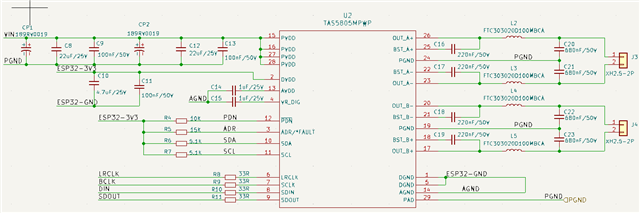

When using the TAS5805, with a 100Hz sine wave and a 16kHz sampling rate, obvious high-frequency noise occurs.
The schematic diagram is as follows:

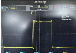

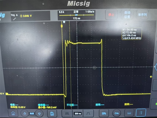

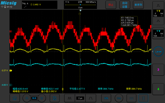

The captured speaker waveform is as follows:
I would like to know how to resolve this abnormal speaker waveform issue, and whether it is a software or hardware problem;
Which aspect should I start with to make improvements?

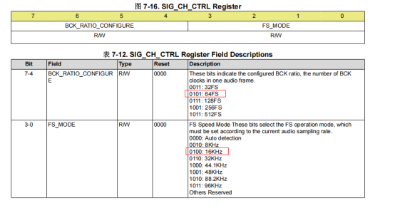

    as i know, tas5805 doesn't support 16khz.
    does it happen in other fs rate?
    also, the output waveform you captured is squared waveform?
    it is the one side output? or the differential output?

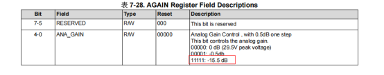

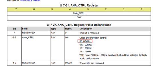

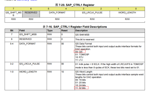

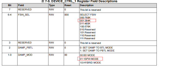

  • 抱歉,没有表达清楚,tas5805设置的参数如下:
    数字音量为12db,其他参数默认,左右通道都是处于播放状态;
    上面抓取的波形是OUT_X的一端,滤波前的一级
    之前我们根据另外一个案列将din拉低到gnd播放发现会有噪音,硬件经过处理后没有噪音了;但是当播放100hz正弦波依然有高频噪音,是一直持续的滋滋的声音,目前没有找到有效的解决办法,请教一下有哪些地方可能造成该现象
