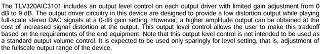

As per the datasheet (page 9), the full-scale differential output is 1.414Vrms with VCM at 1.35V. I want to increase this to 1.838Vrms (a +2.28dB gain).
Is it a feasible and supported method to achieve this by setting the VCM pin to 1.65V (from a 3.3V source)?
