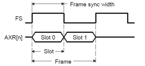

最近在做音频的项目,参考evmc6747中aic3106test例程,有个问题没弄明白,例程中这里
for ( sec = 0 ; sec < 5 ; sec++ )
for ( msec = 0 ; msec < 1000 ; msec++ )
for ( sample = 0 ; sample < 48 ; sample++ )
/* Send a sample to the left channel */
while ( ! ( MCASP1_SRCTL5 & 0x10 ) );
MCASP1_XBUF5_32BIT = (sinetable[sample] << 15) | 0x00000000;
/* Send a sample to the right channel */
因为McASP和芯片都设置成I2S方式,那么每采样放出的帧信号不就应该是左右两个slot了吗?这里为什么要写两次呢?
还有就是我觉得例程中给的正弦波数组应该是Q15格式的吧?这里的<<15|0x00000000是干嘛用的呢?结果是Q31数据?请大家多指教!谢谢!
