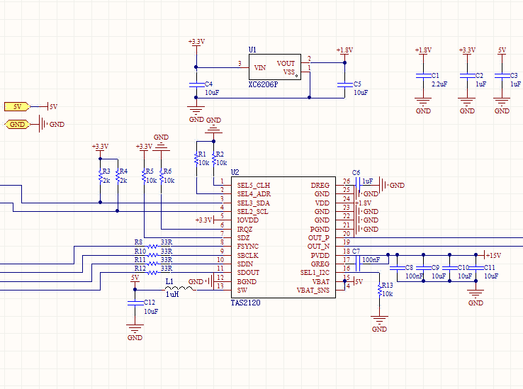

TAS2120: TAS2120 PVDD电压异常 ADC数据转换方式
Part Number: TAS2120
问题1:PVDD电压只有4.5V,而不是15V?
问题2:SAR_ADC_VBAT SAR_ADC_PVDD SAR_ADC数据转换方式是怎么样的?

#define SAR_MONITOR_01_ADDRESS 0x26

    data = BST_MODE_OPEN | BST_EN;
    if (tas2120_i2c_write_data(BST_CFG_02_ADDRESS, &data, 1) != RT_EOK)
        return RT_ERROR;
    if (tas2120_i2c_read_data(BST_CFG_02_ADDRESS, &data2, 1) != RT_EOK)
        return RT_ERROR;

    tas2120_monitor_t monitor;
    tas2120_read_monitor(&monitor);
    return RT_EOK;
rt_err_t tas2120_read_monitor(tas2120_monitor_t *monitor)
    uint8_t buff[5];
    if (tas2120_i2c_read_data(SAR_MONITOR_01_ADDRESS, buff, 5))
        return RT_ERROR;
    monitor->vbat = (buff[0] << 8) | buff[1];
    monitor->pvdd = (buff[2] << 8) | buff[3];
    monitor->temp = buff[4];
    return RT_EOK;
    uint8_t buff[5];
        return RT_ERROR;
    return RT_EOK;
