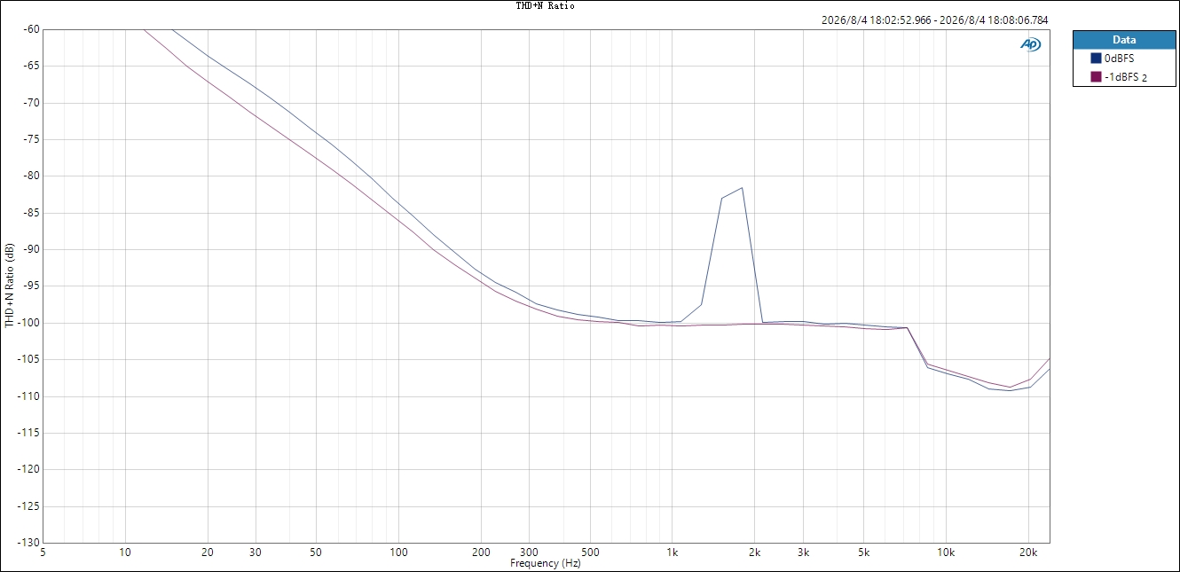

PCM6240-Q1: AC Coupled differential line input THD VS Input Frequency -1dbr Input 20hz=65dB
Part Number: PCM6240-Q1
AC Coupled differential line input,Input=9.08Vrms(SDOUT=-1dBr),THD+N is no -100dB as the picture from EC table-TypicalCharacteristics.
