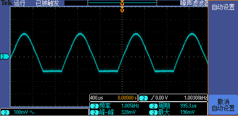

你好!我在用tlv320aic3101 芯片。希望使用pga旁路功能,给芯片输入1k,500mv的正弦波,在差分输出HPLOUT 和HPLCOM处测量输出,HPLOUT处没有偏置电压,频率是1k的,但是波形不对,如附件所示;HPLCOM有2v多的偏置,频率也是1k的,但是波形是正弦波下半部分的一部分;当正弦波的幅度降为240mv左右时,HPLOUT输出是一个1k的正弦波,而HPLCOM则几乎测不到信号。请问,pga旁路出来的波形是否跟输入一样,pga该如何配置?
以下是部分是我的pga通路配置
aic3x_write(codec, 0x08, 0xc0);//master
aic3x_write(codec, 0x12, 0xf0); //18 right adc gain control MIC2R/LINE2R is connected to right-ADC PGA.
aic3x_write(codec, 0x16, 0x7c);//LINE1R is not connected to the right-ADC PGA. Right-ADC channel is powered up.
aic3x_write(codec, 0x10, 0x00);//The right ADC PGA is not muted. gain=0db
aic3x_write(codec, 0x18, 0x78);//LINE1L is not connected to the right-ADC PGA.
//aic3x_write(codec, 91, 0x80); //91
aic3x_write(codec, 0x38, 0x80); //56PGA_R is routed to HPLCOM.
aic3x_write(codec, 0x33, 0x09);//HPLOUT is not muted. HPLOUT is fully powered up.
aic3x_write(codec, 0x31, 0x80); //49
aic3x_write(codec, 0x3a, 0x09); //58 hplcom enalbe
