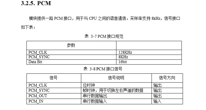

請問, TLV320AIC3262 PCM接口 能否支持如下参数?? 謝謝!
恩 是的,不好意思,datasheet P54中已经给出相关描述:
Each of the three audio buses of the TLV320AIC3262 can be configured for left or right-justified, I
2S, DSP, or TDM modes of operation, where communication with standard telephony PCM interfaces is supported within the TDM mode. These modes are all MSB-first, with data width programmable as 16, 20, 24, or 32 bits.
