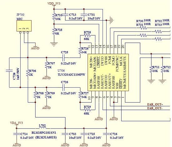

One AIC1106 chip is used as a microphone/speaker PCM data converter. As  figure.1  shows.

My question is:
1. Is the application circuit correct ?
2. If the circuit is correct ( I can't find any thing wrong till now). The 6th bit unusual cause by chip bug?
3. Any software technic can avoid this?
Hope give me a reply to help me to use the AIC1106 in my project. Thanks ahead.
Figure.1 Main part of TLV320AIC1106 application circuit.

  • This is typical of delta-sigma audio ADC. This is caused by the offset voltage of internal circuit. For operational amplifier, when the input is 0, the output has some small DC offset output.  Just like operational amplifier, for delta-sigma audio ADC, when the input is zero, the output is not zero, but some low amplitude output.
    For instrument and industrial application, this offset voltage is harmful and is restrictly controlled. For audio application, however, this low amplitude DC offset is not harmful since only AC signal above 20Hz is used.
    If you still care about the DC offset signal, you can remove it by using a simple 1st order IIR high pass filter in your firmware.

  • As Figure.1 shows, I used two 0.22uF capacitors to avoid external DC offset.  So, the DC offset of digital output  can only caused by the internal circuit.

  • Yongsen,
    You are right. The DC offset is caused by internal circuit.
    IIR is more source effective to remove this DC offset. in codec that has built in HPF to remove the DC offset also use IIR filter (often use one order IIR).
    Best Regards
