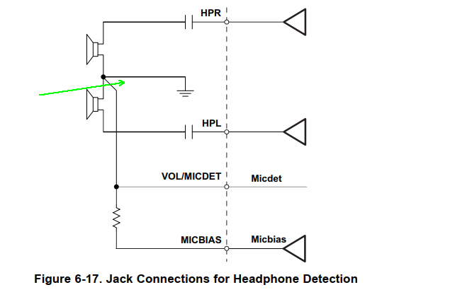

TLV320DAC3101 的规格书中,39页介绍到该料可以实现耳机插拔检测和耳机按钮检测:
1.不知道耳机插拔检测的具体原理如何实现的,规格书中没细说?
2.耳机按钮检测是否可以检测多个按钮,比如接听\挂断、音量+、音量-?
帮忙解答下,谢谢!

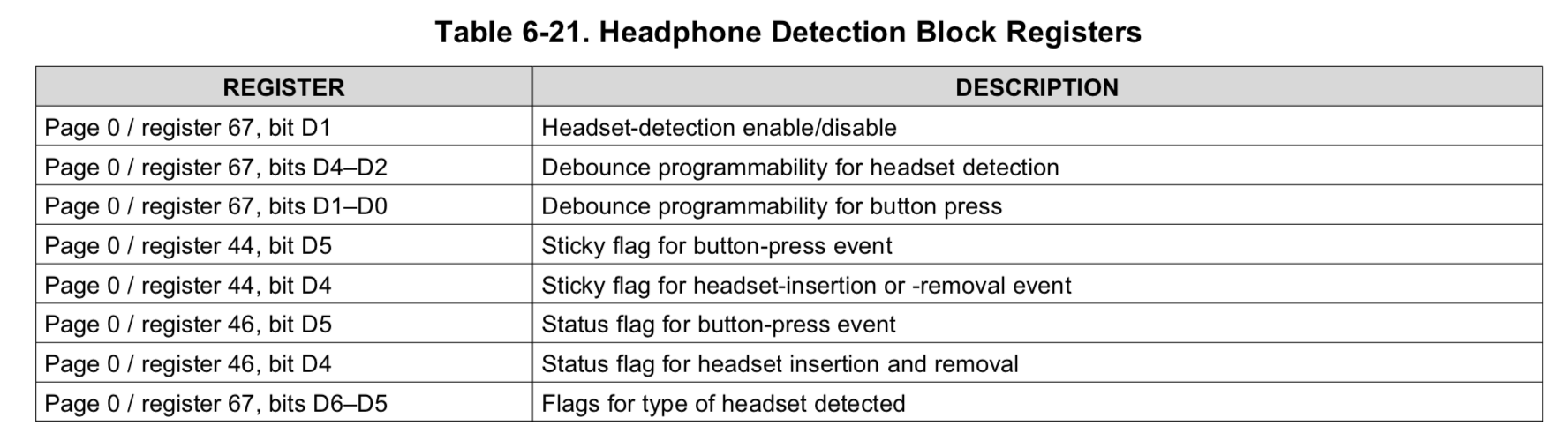

您好,耳机插拔检测和按钮检测,可以参考Table6-21中具体寄存器的描述。
The device not only detects a headset insertion event, but also is able to distinguish between the different headsets inserted, such as stereo headphones or cellular headphones. After the headset-detection event, the user can read page 0 / register 67, bits D6–D5 to determine the type of headset inserted.
关于耳机按钮检测, 通过DAC 中断寄存器Register 44来的bit5来检测,它检测的只是是否有按钮press。所以我理解的是不论是音量,还是挂断接听按钮,都能检测。
