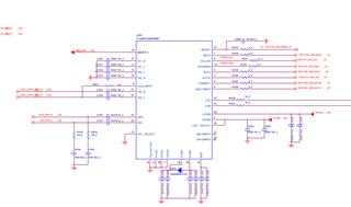

TLV320AIC3204: tlv320aic32x4芯片播放模式没有问题,录音模式无法录音
Part Number: TLV320AIC3204
使用以下命令进行播放,没有问题:
tinymix set "PRI_MI2S_RX Audio Mixer MultiMedia1" "1"
tinymix set "HPL Output Mixer L_DAC Switch" "1"
tinymix set "HPR Output Mixer R_DAC Switch" "1"
tinymix set "HP DAC Playback Switch" "1"
tinymix set "HP Driver Gain Volume" "35"
tinymix set 'HPL Output Mixer IN1_L Switch' 1
tinymix set 'HPR Output Mixer IN1_R Switch' 1
请帮助确认录音的命令是否正确:
tinymix set 'ADCFGA Left Mute Switch' 0
tinymix set 'ADCFGA Right Mute Switch' 0
tinymix set 'MultiMedia1 Mixer PRI_MI2S_TX' 1
tinymix set "IN3_R to Right Mixer Positive Resistor" 1
tinymix set "IN3_L to Left Mixer Positive Resistor" 1
tinymix set "CM_L to Left Mixer Negative Resistor" 1
tinymix set "CM_R to Right Mixer Negative Resistor" 1
原理图如下:
