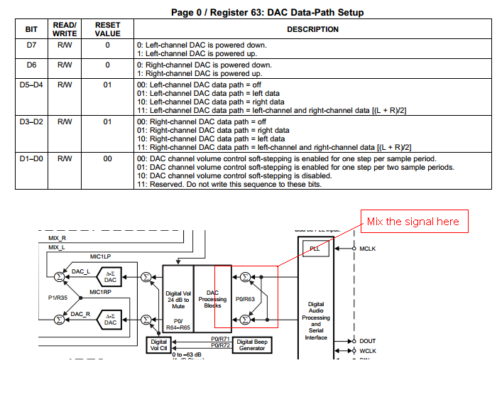

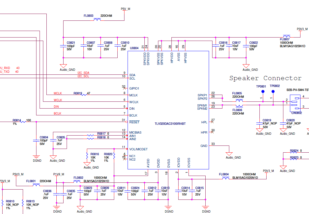

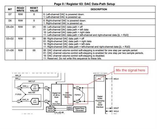

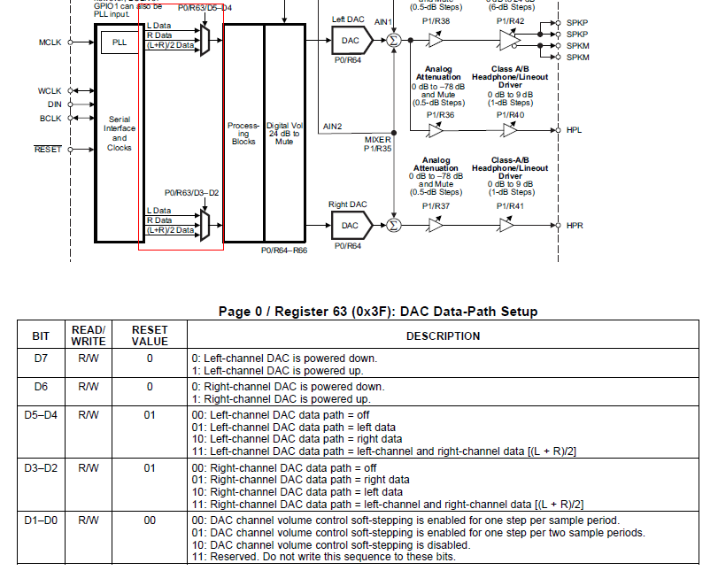

请问TLV320DAC3100的双音源数据能否同时通过speaker输出?
Hi everybody
    We just need send two audio sources which are stored in memory to one speaker.And these two sound sources must be heard in the same time. Could TLV320DAC3100 meet this requirement?
Here is the audio schematic of our system design. We have tested it, but the speaker output sound is not what we expected result. We could not hear the two sound clearly.
Could you help to have a look and give your comment? Thank you very much!
