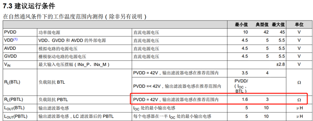

TPA3223DDVR can support 100W/1Ohm at PBTL Mode?
