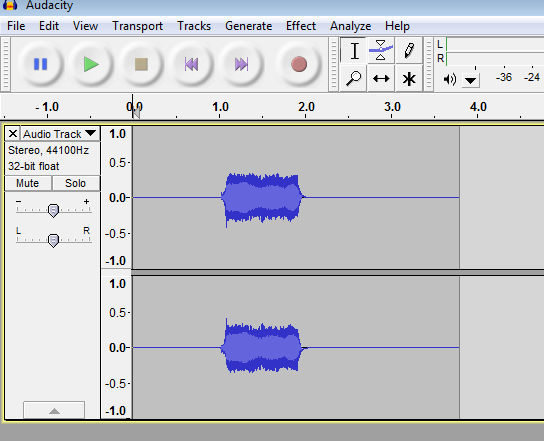

我遇到使用TLV320AIC3254 purepath studio无法录音,不知道什么原因。还请各位帮忙解答。谢谢

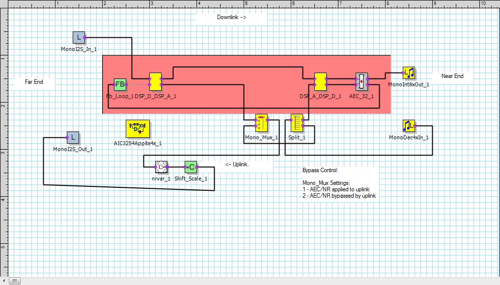

我们先用CS设置好了录音与播放均可以,然后用GDE下载你提供的PPS文件,都不能录音。不知道我们是不是步骤上有问题?

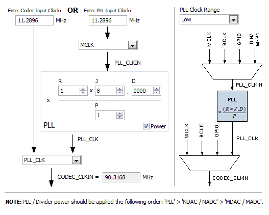

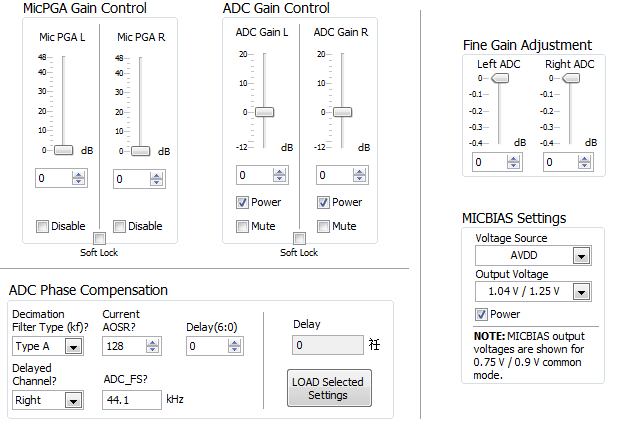

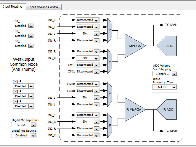

我用PPS生成的代码写入AIC3254只听到杂音,没有声音输入,请您帮我看看哪里出了问题。
下面的配置写入预置模式就有声音输入输出,写入PPS生成的minDsp代码就只能听到一点杂音。

// # reg[ 0][ 5] = 0x94 ; // PLL is powered up, P=1, R=4
{ 5,0x94},
// # reg[ 0][ 6] = 0x2A ;J=42
{ 6,0x2A},
// # reg[ 0][ 7] = 0x00 ; D=0000 (MSB)
{ 7,0x00},
// # reg[ 0][ 8] = 0x00 ; D=0000 (LSB)
{ 8,0x00},
// # reg[ 0][ 4] = 0x03 ; PLL Clock is CODEC_CLKIN
{ 4,0x03},
// # reg[ 0][254] = 0x0a ; Delay 10ms for PLL to lock
{254,0x0A},
// # reg[ 0][ 12] = 0x82 ; MDAC = 14, divider powered on
{ 12,0x8E},
// # reg[ 0][ 13] = 0x01 ; DOSR = 384(MSB)
{ 13,0x01},
// # reg[ 0][ 14] = 0x80 ; DOSR = 384(LSB)
{ 14,0x80},
// # reg[ 0][ 18] = 0x82 ; // NADC divider powered up, NADC = 2
{ 18,0x82},
// # reg[ 0][ 19] = 0x95 ; MADC = 21, divider powered on
{ 19,0x95},
// # reg[ 0][ 20] = 0x00 ; AOSR = 256
{ 20,0x00},
// # reg[ 0][ 11] = 0x8E ; NDAC = 2, divider powered on
{ 11,0x82},

// # reg[ 1][ 51] = 0x40 ; // MICBIAS powered up ON Board Mic
{ 51,0x40},
// # reg[ 1][ 52] = 0x00 ; not routed to Left MICPGA
{ 52,0x00},
// # reg[ 1][ 54] = 0x04 ; IN3R is routed to Left MICPGA with 10k resistance
{ 54,0x04},
// # reg[ 1][ 55] = 0x04 ; IN3R is routed to Right MICPGA with 10k resistance
{ 55,0x54},
// # reg[ 1][ 57] = 0x40 ; CM is routed to Right MICPGA via CM1R with 10k resistance
{ 57,0x40},
// IN3R input is weakly driven to common mode.
{ 58,0x04},
// # reg[ 1][ 59] = 0x5E ; //make channel gain 0dB, since 20K input //impedance is used single ended
{ 59,0x00},
// # reg[ 1][ 60] = 0x00 ; Enable MicPGA_R Gain Control, 0dB
{ 60,0x00},
{ 83,0x68},
{ 84,0x68},
