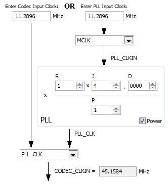

    PLL部分您如何设置的?如果WCLK设为output,谁做为PLL的分频源?或者BCLK的时钟是从哪里来的?
    可以将WCLK设为input,再将WCLK作为PLL的分频源,再向下分频给BCLK。
    与CLK相关的寄存器如下,供参考:

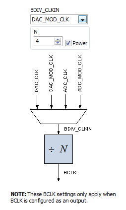

    我是用MCLK(11.5MHz)作为PLL输入的(Page 0 Register 4 D3-D2=0x00),P、R、J、D、M、N的值也设置好了,BCLK的时钟(BDIV_CLKIN)输入设置为ADC_MOD_CLK(Page 0 Register 30 D1-D0=0x11),BCLK N的值也设置并开启了。然后Page 0 Register 27 D3-D2=0x11,也就是BCLK和WCLK都设置为输出了。

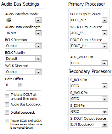

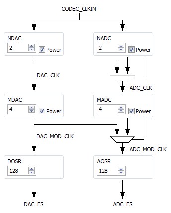

    如果按照你这个思路设置,BCLK选用ADC_MOD_CLK,还需要设置AOSR,使ADC_FS=44.1K。然后注意选择WCLK的来源为ADC_FS。即page0 0x21寄存器为0x10。这样设置了,就可以得到MCLK得到的BCLK和WCLK。

    相关寄存器配置:
    Register Hex Register Name Reset Value Current Value
    Register 4 0x04 Clock Setting Register 1, Multiplexers 0x00 0x03
    Register 5 0x05 Clock Setting Register 2, PLL P&R Values 0x11 0x91
    Register 6 0x06 Clock Setting Register 3, PLL J Values 0x04 0x04
    Register 7 0x07 Clock Setting Register 4, PLL D Values (MSB) 0x00 0x00
    Register 8 0x08 Clock Setting Register 5, PLL D Values (LSB) 0x00 0x00
    Register 9 0x09 Reserved 0x00 0x00
    Register 10 0x0A Reserved 0x00 0x00
    Register 11 0x0B Clock Setting Register 6, NDAC Values 0x01 0x82
    Register 12 0x0C Clock Setting Register 7, MDAC Values 0x01 0x84
    Register 13 0x0D DAC OSR Setting Register 1, MSB Value 0x00 0x00
    Register 14 0x0E DAC OSR Setting Register 2, LSB Value 0x80 0x80
    Register 15 0x0F DAC miniDSP instruction control Register 1 0x02 0x02
    Register 16 0x10 DAC miniDSP instruction control Register 2 0x00 0x00
    Register 17 0x11 DAC miniDSP Interpolation Factor Setting Register 0x08 0x08
    Register 18 0x12 Clock Setting Register 8, NADC Values 0x01 0x82
    Register 19 0x13 Clock Setting Register 9, MADC Values 0x01 0x84
    Register 20 0x14 ADC Oversampling (AOSR) Register 0x80 0x80
    Register 21 0x15 ADC miniDSP instruction control Register 1 0x01 0x01
    Register 22 0x16 ADC miniDSP instruction control Register 2 0x00 0x00
    Register 23 0x17 ADC miniDSP Decimation Factor Setting Register 0x04 0x04
    Register 24 0x18 Reserved Register 0x00 0x00
    Register 25 0x19 Clock Setting Register 9, Multiplexers 0x00 0x00
    Register 26 0x1A Clock Setting Register 10, CLKOUT M divider value 0x01 0x01
    Register 27 0x1B Audio Interface Setting Register 1 0x00 0x0C
    Register 28 0x1C Audio Interface Setting Register 2, Data offset setting 0x00 0x00
    Register 29 0x1D Audio Interface Setting Register 3 0x00 0x01
    Register 30 0x1E Clock Setting Register 11, BCLK N Divider 0x01 0x84
    Register 31 0x1F Audio Interface Setting Register 4, Secondary Audio Interface 0x00 0x00
    Register 32 0x20 Audio Interface Setting Register 5 0x00 0x00
    Register 33 0x21 Audio Interface Setting Register 6 0x00 0x10
    Register 34 0x22 Digital Interface Misc. Setting Register 0x00 0x00
    Register 35 0x23 Reserved Register 0x00 0x00
    Register 36 0x24 ADC Flag Register 0x00 0x00
    Register 37 0x25 DAC Flag Register 1 0x00 0xEE
    Register 38 0x26 DAC Flag Register 2 0x00 0x11
    这样配置在我们的EVM上是有时钟的,你check一下。

    我把AOSR设置为256就行了,现在都能够回放声音了(不用旁通模式)。
    现在的参数如下:J=8,M=8,AOSR=256,其它参数设置和你的一样,最后的采样率只有22kHz多一些,我输入的MCLK=13MHz左右。
    也就是说以前的问题是:从BCLK一直有输出看来,ADC_MOD_CLK之前的时钟模块是没问题的,而原因是在于AOSR太小导致ADC_FS太高了?

    设置时钟的时候需要先初步计算一下,对于格式是16bit的I2S,如果ADC_FS或者DAC_FS=44.1Khz,或者48K等常用的采样频率,那么WCLK就等于采样率,BCLK最小需要设置为2*16*44.1k=1.4112Mhz,所以如果选择ADC_MOD_CLK,需要根据ADC_MOD_CLK的值来选择分频系数N。或者前级的分频配合,保证BCLK>=2fs*16bit。
    这样BCLK和MCLK就不会错。
