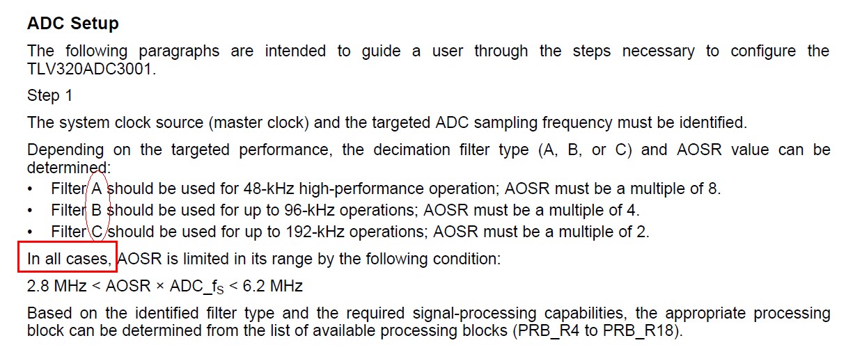

Supports ADC Sample Rates From 8 kHz to 96 kHz,在TLV320ADC3001手册首页中提示其采样频率为8kHz~96kHz。
但是在第40页:
Step 1
The system clock source (master clock) and the targeted ADC sampling frequency must be identified. Depending on the targeted performance, the decimation filter type (A, B, or C) and AOSR value can be determined:
Filter A should be used for 48-kHz high-performance operation; AOSR must be a multiple of 8.
Filter B should be used for up to 96-kHz operations; AOSR must be a multiple of 4.
Filter C should be used for up to 192-kHz operations; AOSR must be a multiple of 2.
In all cases, AOSR is limited in its range by the following condition: 2.8 MHz < AOSR *ADC_fS < 6.2 MHz
AOSR的取值范围是1~256,假设ADC_Fs=8kHz,8*256=2.048MHz,这不在2.8~6.2M的范围。
请TI解释一下吧

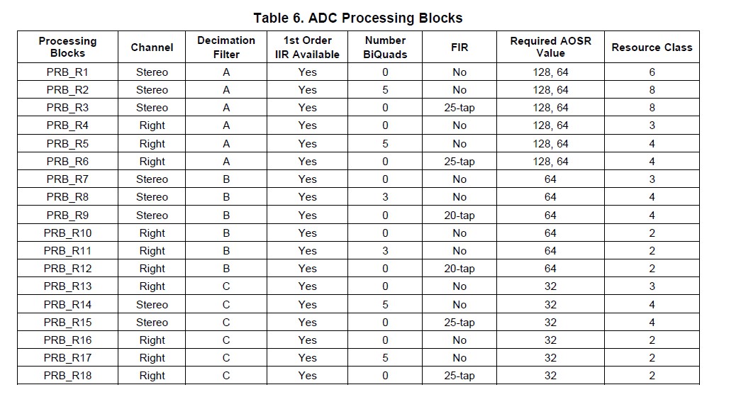

  • 你好,
    关于datasheet中的描述,主要是针对于 filter A/B/C各自适应的场合来说的,filter A BC 分别 支持48K,96K,192K
    那么对于8K采样率分频参数的选取,取决于要使用哪一个PRB,对于相应的PRB,我们有推荐的AOSR值,以确保获得最好的性能。
    比如使用PRB——R1,那AOSR推荐的值是128或者64,这是为了获得8K的采样率,需要调整其它分频参数

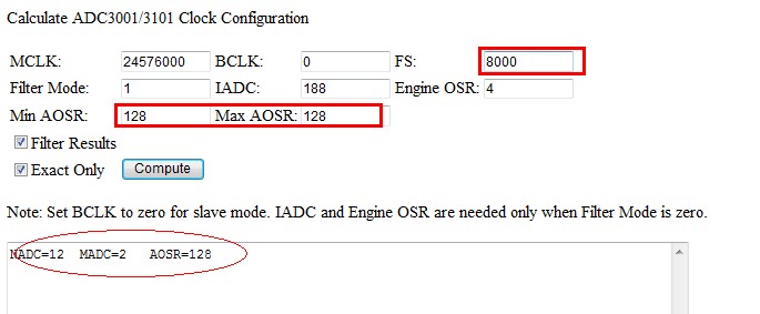

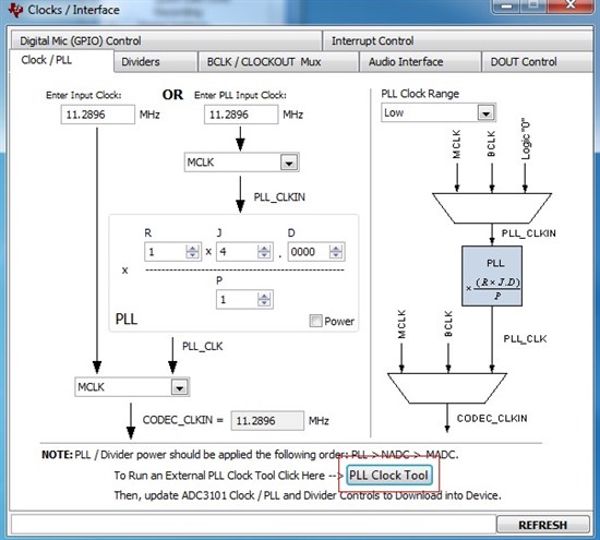

    在AIC3101的GUI上,有一个工具来计算
    比如选择AOSR 为128,采样率为8K,计算得结果如下:
