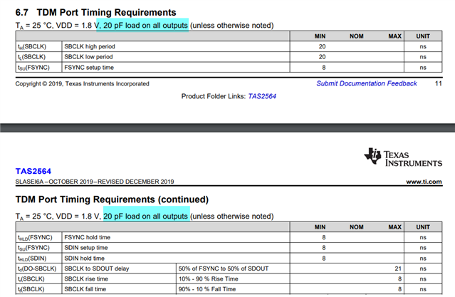

    DOUT在不同的电容负载CL下会有不同的延迟、上升时间、下降时间,datasheet 给出的是20pF电容负载下的参数,如果您需要的速率比较大,那么在PCB layout时就需要注意避免寄生电容的产生以避免更长时间的延迟。
  • td(DO-SBCLK)是DOUT发出时相对BCLK的延迟,跟CL和PCB layout有什么关系?完全是PA自身定义的啊
  • 有一些关系,CL和PCB走线产生的CL会延缓信号的上升沿和下降沿,在对信号幅值定义不变的情况下,CL越大延迟就越大,因此 datasheet 给出了负载条件 即20pF下。

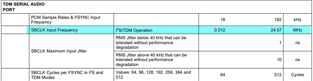

    请注意SBCLK可以使用的最大频率是24.57MHZ:

    Regarding capacitive load, the timing diagrams already consider the capacitive load as specified at the top of the table.

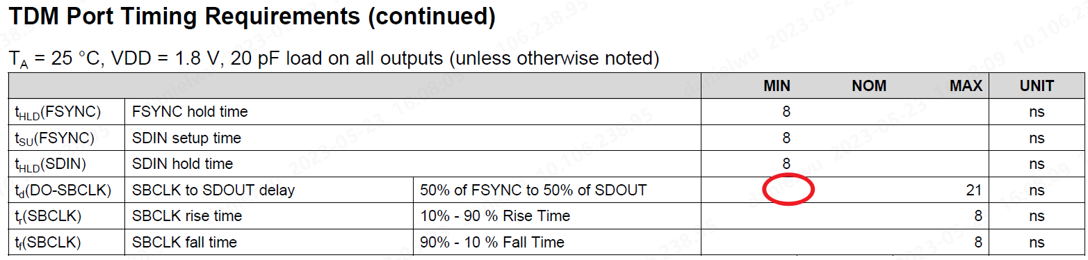

  • 现在只剩下最后一个问题请帮忙确认下:td(DO-SBCLK)的最小值是多少?
  • td(DO-SBCLK)只有最大值,美国工程师想知道您为什么需要这个最小值,我向他描述了您上述情况,他可能不明白,他说用图应该可以更好说明清楚您的问题

  • 得到的回复是:
    As there is no constraint for short td(DO-SBCLK) is the minimum spec in this case is 0.

    • Perhaps customer specs for setup and hold times, are referred to digital data output from SoC to TAS2564, meaning SDIN from TAS2564 perspective. There are similar setup and hold times called for SDIN in TAS2564 data sheet, and both are higher than 6 and 4 ns respectively.
    • td (DO-SBCLK) spec is the time after the sampling edge until the next SDOUT transition. As long as SDOUT is properly latched during the selected SBCLK edge, the delay from the end of that edge to the next transition on SDOUT can take as much as 21ns, but there is no minimum because the data is already latched. This is the reason why no minimum is specified in this case.
    Hope this helps close this question, let us know otherwise.
