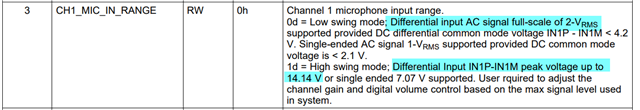

       I use the  DC-Coupled Microphone Differential Input  mode. so if the  DC differential common mode voltage IN1P - IN1M < 4.2
    V, i  should set the CHx_MIC_IN_RANGE to Low swing mode. If  set  to the High swing mode, there would   have Additional attenuation.
    Am I  right?

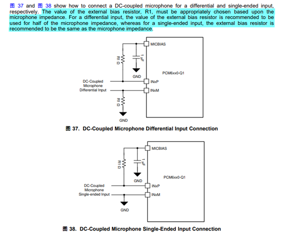

    by the way, do you have   DC  coupled External Ressitor calculator  tools?
  • Yes, you are right. It can be calculated that it is -14dB.
    For DC coupled, external resistors can be selected according to the following description,  i.e. 'For a differential input, the value of the external bias resistance is recommended to be used for half of the microphone impedance, where as for a single ended input, the external bias resistor is recommended to be the same as the microphone impedance.'

    The value of -14dB you have calculated is match the actual measurementsour in our application(DC-Coupled Microphone Differential Input  mode).
    Now we want to change using DC-Coupled Microphone Single-end Input mode.
    Can you calculated the attenuation value again. Also I wish you can share the formula with us, thank you.

  • Sorry for missing your question.
    when CHx_MIC_IN_RANGE=0,Differential input full-scale of 2-VRMS=2*1.414=2.828Vpp
    when CHx_MIC_IN_RANGE=1,Differential input full-scale of 2-VRMS=14.14Vpp
    The attenuation value can be calculated : 20log(2.828Vpp/14.14Vpp)=-14dB
    When using single ended input, the input amplitude is half of the original, which is 1.414Vpp and 7.07Vpp.
    Both methods should be possible, and it is recommended to choose the Gain register to achieve low noise performance as described in the screenshot of the datasheet. It should be noted that after ADC is powered on, the GAIN cannot be changed.

  • Under the same configuration, the gain of single-ended input and differential input is different, and the gain of single-ended input is twice that of differential input, or they have a relationship of 6dB.
    I would like to know under what circumstances you measured -8dB, could you describe it in detail?
  • Yes, in our system, we found that under the same configuration, the difference between single-ended input and differential input attenuation is 6dB.
    The circumstances is DC-Coupled Microphone Single-end Input High swing mode. →the attenuation value is -8dB
    The circumstances is DC-Coupled Microphone Differential Input High swing mode. →the attenuation value is -14dB
    According to your tips, the formula of differential attenuation is 20log(2.828Vpp/14.14Vpp)=-14dB.
    Can you tell me what the formula of single-end attenuation is?
    Thank you.
  • Does the formula of single-end is 20log((1.414/7.07)*2)=-8dB?
  • When AC-coupled single-ended Input connection, what is the attenuation gain?
    The above Excel calculator tool has its input circuit, and I believe you can simulate the gain under different input configurations. When DC coupled single ended Input is used, its gain may be -8dB, but I did not simulate it. You can simulate and verify it.
